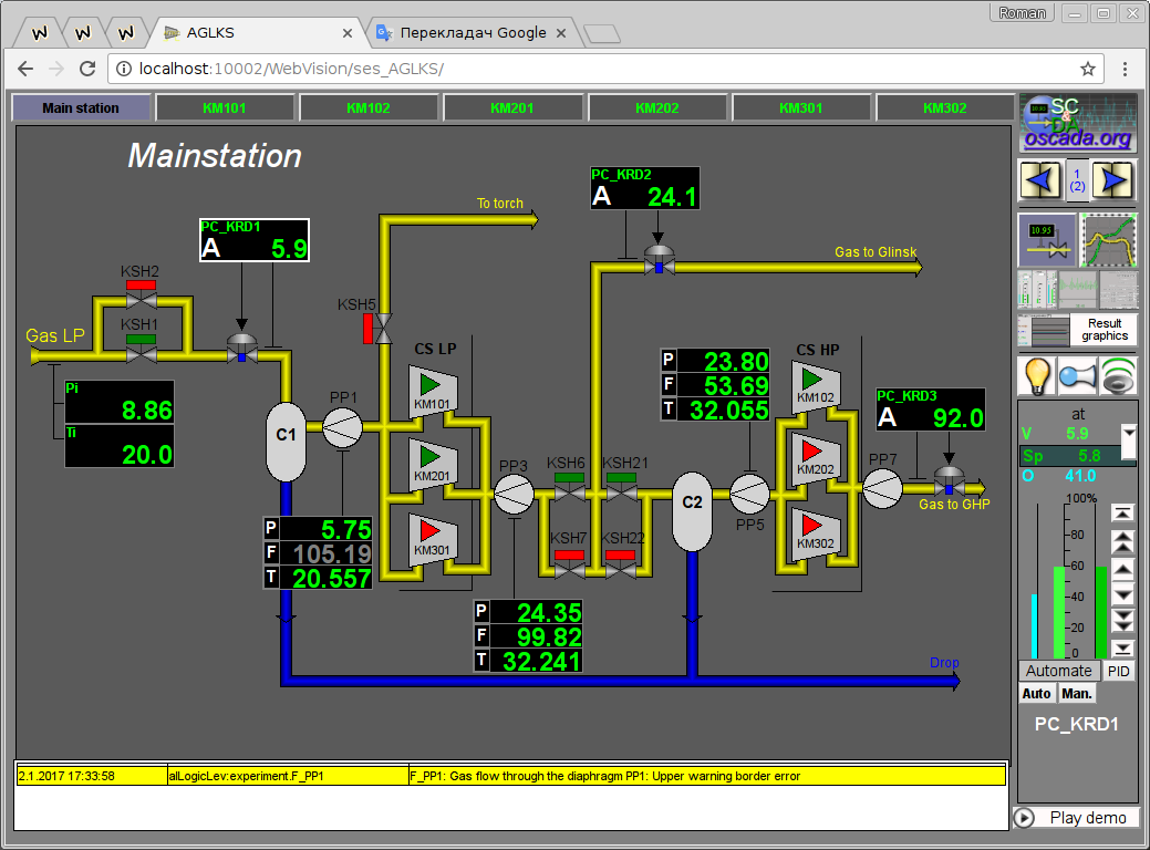

2. Execution of the VCA interfaces
Execution of the VCA interface is to run a new project session or connect to the existing one on the level of VCA engine (Fig.2). Before the connection request to the session the authentication of the user request is done. Then the module of direct visualization represents and manages the data of the session. The main window of the execution mode of this module has the form presented at Fig.3.
The interface of the execution window is fully dynamically built by the JavaScript script on the basis of the contents of the session of the project through direct XML requests to the server.
Update of the contents of the open pages of the visualization interface with the frequency of the visualized session of the project of visualization. In the updating process it is performed:
The mechanism of the request of the only modified data is based on an absolute counter of the session execution. If you want to make real changes in the attributes of widgets the memorizing of the value of this counter is done, which allows the identification of modified attributes. This approach can increase productivity and reduce the traffic in the case of access to the VCA engine via network.
Hierarchically the module provides an opportunity to accommodate the project pages in the main execution window of the WEB-browser (Fig.3), as well as putting them inside of the container widgets.

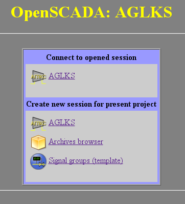

Connection or the creation of a new session of the project's execution of the VCA. (23 Êá)
Fig.2. Connection or the creation of a new session of the project's execution of the VCA.
The main execution window. (115 Êá)
Fig.3. The main execution window.

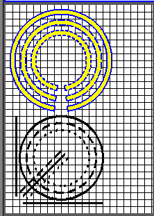

3.1. Elementary figure primitive (ElFigure)
Support of the elementary figures is implemented: lines, elliptical arcs, Bézier curves and fill of the enclosed space with the color and/or image with the properties:
Figure shows a part of the screen with a frame containing the elementary figures.
A part of the screen with a frame containing the elementary figures. (7 Êá)

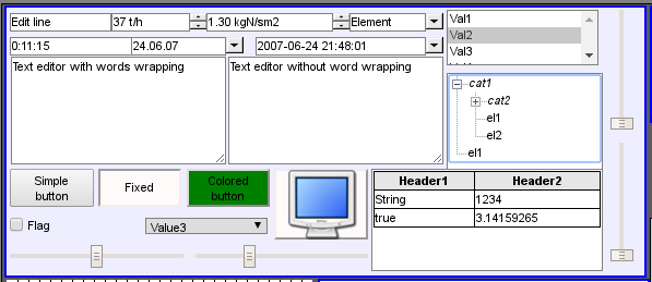

3.3. Primitive of the form element (FormEl)
Support of the form elements on the VCA frames is provided. The following form elements are included:
The following modes are realized: "Enabled" and "Active", as well as transfer of changes and events to the data model of the VCA (engine). For all realized representations the active mode is supported, ie elements can be used to create the forms of user input.
Figure represents a part of the screen with the frame containing the above-listed elements of the form.
A part of the screen with the frame of elements of the form. (21 Êá)

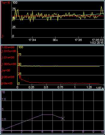

3.5. Primitive of the construction of diagrams/graphs (Diagram)
The diagrams construction element releases for types "Graph", "Spectrum" and "XY" with properties:
Figure represents a part of the screen with the frame containing examples of the diagrams: "Graph", "Spectrum" and "XY".
Realization of the basic element of a diagram-trend displaying in the WebVision. (11 Êá)

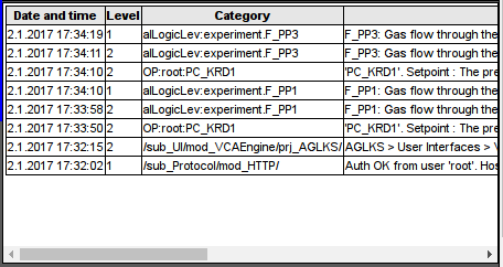

3.6. Primitive of the protocol formation (Protocol)
Support of the element of the formation of the protocol with the following properties is provided:
Figure represents a part of the screen with the frame containing an example of the protocol.
A part of the screen with the frame containing an example of the protocol. (14 Êá)

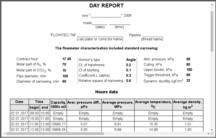

3.7. Primitive of the report formation (Document)
Support element of the report formation with the following properties is provided:
The basis of any document is XHTML-template. XHTML-template is the tag "body" of the WEB-page which contains the document's static in the standard XHTML 1.0 and elements of the executable instructions in one of the languages of the user programming of OpenSCADA in the form of <?dp {procedure} ?>. The resulting document is formed by the execution of procedures and insert of their result into the document.
The source for values of the executable instructions are the attributes of the widget of the primitive, as well as all the mechanisms of the user programming language. Attributes may be added by the user and they can be linked to the actual attributes or parameters or they can be autonomous, values of which will be formed in the script of the widget. In the case of linked attributes the values can be extracted from the history, archive.
Figure shows the frame containing a sample of the document.
The frame containing a sample of the document. (48 Êá)

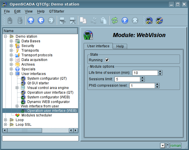

4. The overall configuration of the module
To adjust the module overall behavior provide several parameters configuration through the management interface of the OpenSCADA (Fig. 11):
Configuration page of the module (72 Êá)
Fig.11. The configuration page of the module.
