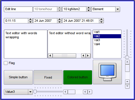

6.4.2 Primitive of the form element (FormEl)
The implementation on the data-model side (UI.VCAEngine) describes into the document's part 4.12.
UI.Vision
Support of the form elements on the VCA frames is provided. The following form elements are included:
The following modes are realized: «Enable» and «Active», as well as transfer of changes and events to the data model of the VCA (engine).
Figure represents a part of the screen with the frame containing the above-listed elements of the form.
Realization of the form elements in the Vision (18 Êá)
UI.WebVision
The following modes are realized: "Enabled" and "Active", as well as transfer of changes and events to the data model of the VCA (engine). For all realized representations the active mode is supported, ie elements can be used to create the forms of user input.
A part of the screen with the frame of elements of the form. (21 Êá)

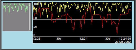

6.4.5 Primitive of the construction of diagrams/graphs (Diagram)
UI.Vision
The diagrams construction element releases for types "Graph", "Spectrum" and "XY" with properties:
The module of visualizer provides and uses set of specific attributes of the generic means, its information are into next table. Theses attributes create by the visualizer, on its lack, at a first start.
Id Name Appointment
sclWin Scaling of a window selected part, by the mouse. It is logical type attribute created by the user manually at needs. The "true" value enables the scaling of a window selected part, by the mouse.
Figure represents a part of the screen with the frame containing examples of the diagrams: "Graph", "Spectrum" and "XY".
Realization of the basic element of a diagram-trend displaying in the Vision. (10 Êá)
UI.WebVision
Realization of the basic element of a diagram-trend displaying in the WebVision. (11 Êá)

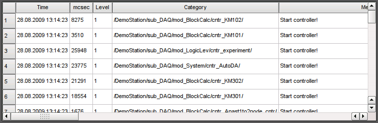

6.4.6 Primitive of the protocol formation (Protocol)
UI.Vision
Support of the element of the formation of the protocol with the following properties is provided:
Figure represents a part of the screen with the frame containing an example of the protocol.
Realization of the basic element of visualization of the protocol in Vision (34 Êá)
UI.WebVision
A part of the screen with the frame containing an example of the protocol. (14 Êá)
