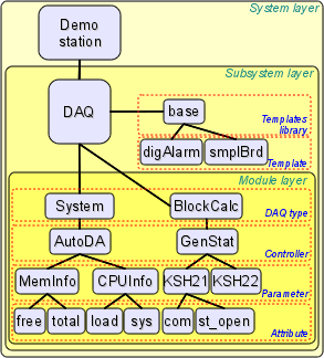

The variety of data sources has created a wide range of mechanisms to access them. Local data sources are different in application programming interface (API), and network sources, in their turn, in transport and protocol interaction level. In general, this has led to the fact that the addition of support for a new data source requires the creation of interface module or driver. Taking into account the great variety of sources, it is extremely expensive and actually impossible to cover the entire spectrum of the market of these devices. The situation is somewhat simplified with the network source due to the presence of the number of standard and free interaction protocols, but many sources still use their own protocols: private, commercial or protocols, tied to private mechanisms of the limited range of commercial operating systems (OS).
In terms of OpenSCADA system the following objects to serve the data acquisition mechanism are provided:
To account the features of different data acquisition devices, as well as the different mechanisms of interaction in the OpenSCADA the modular subsystem "Data acquisition" is provided. The module of the subsystem is the driver for interfacing with a data source of specific type. Each module can contain a configuration of several devices of this type in the form of "Controller" objects of OpenSCADA. The general scheme of objects of "Data acquisition" subsystem is shown in Figure 1.
The subsystem\'s [Data acquisition] scheme. (41 Êá)

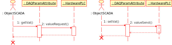

The mechanism is characterized by requests to the data source synchronously with the request to the attribute of parameter (Fig. 2). This mechanism is usually used when working with local sources of data, characterized by low latency, i.e. delay in response to the request. With this method you can get actual data directly with the request, but the time of the request of object will include the time for transportation and processing of the request by the data source.
 (10 Êá)
Fig. 2. Diagram of the sequence of interaction with the synchronous requests.
In accordance with the diagram above, we obtain the following sequence of requests for data acquisition and their transfer:

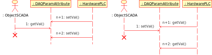

1.2. Simple asynchronous acquisition mechanism

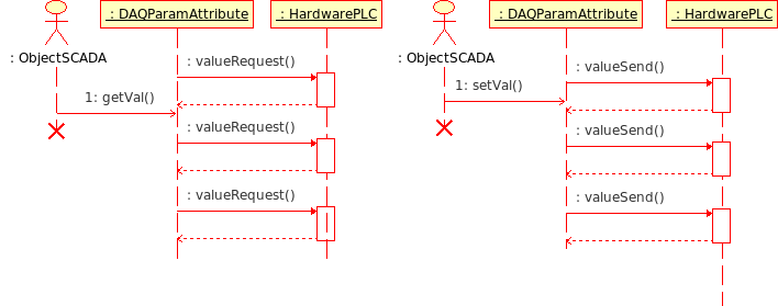

The mechanism is characterized by requests to the data source, regardless of the request to the attribute of parameter (Fig. 3). Usually, requests to the source of the data are made periodically in the own polling task of the single controller and with the blocks of few signals. This request to the parameter's attribute returns the value obtained from the last connection session with the data source. This mechanism is usually used when working with remote (network) data sources, characterized by high latency, i.e. delay in the response to the request.
With this method it's possible to optimize the time resource spent on one signal, and thereby increase the maximum number of requested signals during the time interval of the polling.
As an example, lets examine an industrial PLC Siemens S7-315 during requesting him on the bus ProfiBus (1,5 Mbit/s). The average processing time of the MPI-request of this controller is 30 ms. If you use a synchronous mechanism for each signal, i.e. one request for each signal, then in one second we can get something about 33 signals. And if you apply the asynchronous mechanism, i.e. in the MPI-package to receive up to 220 bytes or 110 signals of integer type of 16-bit, then we can for one second get up to the 3630 signals. As you can see, the effectiveness of the asynchronous mechanism in this case is 110 times, that is the maximum capacity of MPI-package.
The disadvantage of asynchronous mechanism is that the request of the value of attribute of the parameter returns not actual at the time of request value, but value of the last session of the polling of the controller. However, taking into account that the source of data can be updated at intervals of ADC hardware limitations, and the sensors themselves may have certain restrictions on the reaction rate, the using of the asynchronous acquisition mechanism could have a serious grounds.
Application of the asynchronous mechanism for recording the values to the PLC is a fairly rare fact, because recording of values usually involves impact of the operator on the TP. Operator on the fact rarely makes adjustments to the process, therefore, the recording can be performed synchronously. However, there are situations, such as managing of the TP by the regulator on SCADA-system, acting as a runtime of PLC.
 (15 Êá)
Fig. 3. Diagram of the sequence of interaction with the asynchronous requests.
In accordance with the diagram above, we obtain the following picture:

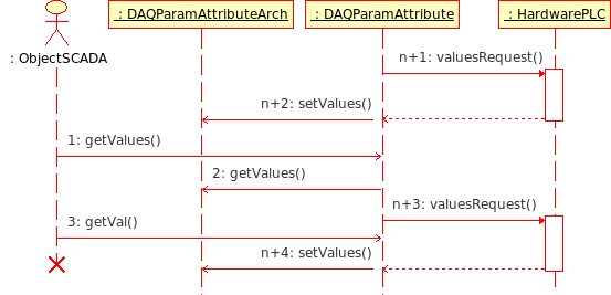

Package data acquisition mechanism is characterized by the acquisition of data for each signal by the packet that includes the history of its changes. I.e. per one session of data poll we obtain multiple values of history of the signal. The package mechanism works in conjunction with synchronous and asynchronous mechanisms.
In the case of working with a synchronous mechanism the actual transfer of the archive of data source for operational work in the system is done (Fig. 2). As the simple synchronous mechanism, it's desirable to apply only to low-latency data sources or to the sources whose work is a session type, for example, in the commercial account to read the values of the counters.
When working in conjunction with an asynchronous mechanism the history of the received signals is usually placed directly in the archives (Fig. 4), and the current value of the parameter's attribute is set to last value of the package. This combination is effective during the acquisition of the fast data or during the synchronization of the archives after the loss of connection to the remote data source.
 (16 Êá)
Fig. 4. Diagram of the sequence of interaction with the asynchronous requests of the package mechanism.
In accordance with the diagram above, we obtain the following behavior of the package mechanism for asynchronous requests:

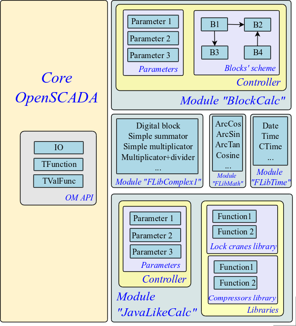

In the OpenSCADA system the programming interfaces and virtual data sources on the basis of different languages in separate modules of a subsystem "Data acquisition" can be implemented. At the current time the available modules of virtual calculators are:
At the OpenSCADA kernel the mechanism for user-defined functions or API of user programming is integrated. User functions can be provided by any object of the system, including modules in accordance with their functionality, thus providing the user with the set of functions for the control of one or another object. User API functions can be either static, i.e. implementing the fixed functionality of an individual object, and the dynamic ones, i.e. formed by the user for the desired task in the language of the user high-level programming.
Module JavaLikeCalc provides the OpenSCADA system with the mechanism to create dynamic user-defined functions and libraries for Java-like language. Description of functions for Java-like language is to tie up the parameters of the function by the algorithm. In addition, the module has the functions of the direct calculations by creating a computer controllers with the associated computational function. Module provides the mechanism to precompile the context-dependent functions that are used to embed the user algorithms directly in the context of the various components of OpenSCADA. For example, the mechanism of the parameters' templates of subsystem "Data acquisition" and the visual control engine (VCA).
Module BlockCalc provides the OpenSCADA system with the mechanism for creating user calculations. Mechanism of calculations based on the formal language of block diagrams. Languages of block programming based on the concept of block diagrams (functional blocks). And depending on the nature of the block, block scheme can be: logic circuits, relay logic circuits, a model of technological process and others. The essence of the block scheme is that it contains the list of blocks and links between them. From a formal point of view the block — is an element (function), which has inputs, outputs and an algorithm for computing. Based on the concept of programming area block — is a frame of values associated with the object of function. Inputs and outputs of blocks are to be connected to get the whole block scheme.
With the purpose of filling user programming API with user functions the following specialized modules of static user programming API functions are created:
The overall structure of the components of the programming area (85 Êá)

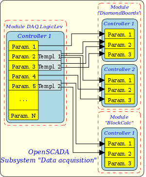

The conception of "Logic Level" based on the parameters' templates for which in the subsystem "DAQ" it's provided the container of the templates libraries (Fig. 1). Each library contains templates of parameters that can be used by the modules of "DAQ" subsystem for the implementation of parameters based on templates. The modules of OpenSCADA, which use the templates in their work, are:
General mechanism of the "Logic Level" on the example of the LogicLev module is shown in Figure 7.
The mechanism of the "Logic Level" on the example of LogicLev module. (31 Êá)
Fig. 7. The mechanism of the "Logic Level" on the example of LogicLev module.
On the figure you can see that the parameters of the logic level controller function as reflections of other parameters of "DAQ" subsystem (on the example of parameters 1 and 4) and the free formation of parameters based on templates 1, 2 and other parameters of "DAQ" subsystem (on the example of the parameters 2, 3 and 5).

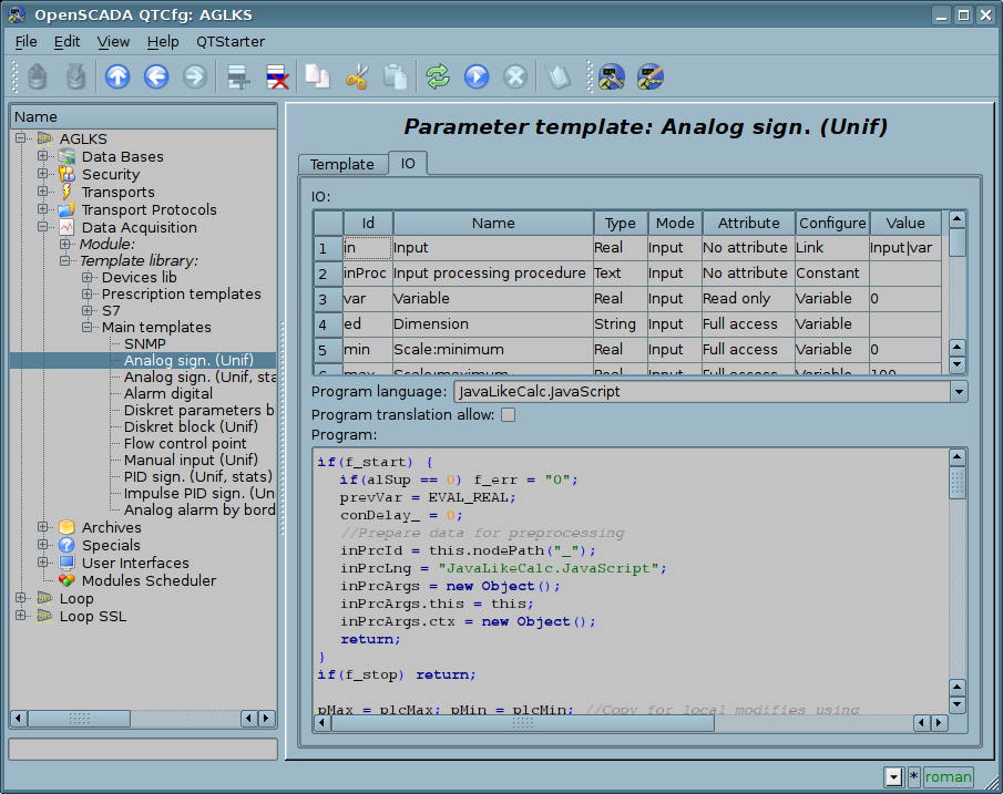

Figure 9 shows image of the configuration tab of the parameters' template of subsystems "DAQ" as the table with the configuration of inputs/outputs and the text of the program of user programming.
The configuration tab of parameters' template of subsystem "DAQ". (134 Êá)
Fig. 9. The configuration tab of parameters' template of subsystem "DAQ".
The input/output tab of the parameter's template provides the following properties of special purpose: "Attribute", "Configure" and "Value".
The "Attribute" property is the reflecting sign of the the I/O of the template on the resulting attribute of the parameter. There the following options for this property are provided:
The "Configure" property is the sign indicating the using of input/output of the template's function in the resulting configuration of the template on the logic level. The following options for this property are provided:
The field "Value" describes the preset value for the constants and configuration template of the external links. Template of the configuration of external links is used to describe the mechanism of grouping and automatic allocation of external links. The structure of the template of configuration of external links is the specific for each module of subsystem "DAQ", which uses the template's mechanism. In the case of the logic level module the allocation is made over the external attributes of the parameters with the template of configuration of the external link of the form: {Parameter}|{attribute}. Where "Parameter" is used to combine the parameters and place on the configuration form, and an attribute — for the associated linkage of the attributes at the appointment of the parameter.

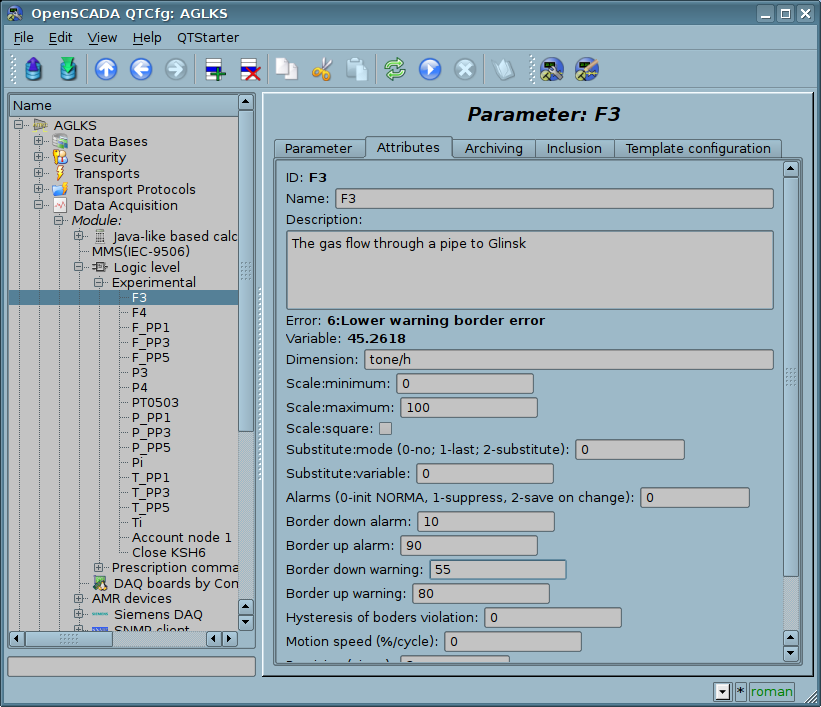

As an example of the template's using in Figure 10 lets show an images of the parameter of the logic level module "F3". In Fig.10 the tab "Template config" is presented', it serves for the configuration, including the linkage, of the parameter's template. In Fig.11 the tab "Attributes" is shown with the list of attributes and their values, created through the template.
The "Template config" tab of the "F3" parameter of the logic level module. (79 Êá)
Fig. 10. The "Template config" tab of the "F3" parameter of the logic level module.
The "Attributes" tab of the "F3" parameter of the logical level module. (110 Êá)
Fig. 11. The "Attributes" tab of the "F3" parameter of the logical level module.

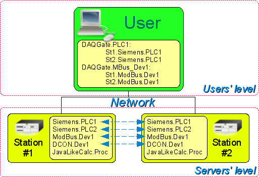

4. Redundancy of the data sources
Redundancy in general and of the data sources in particular serves to increase the overall level of fault-tolerance of the solution by integrating the redundant nodes in collaboration with the main node. In case of failure of the main node the grab of the main node functions by the redundant one takes place. The redundant scheme can work in the mode of load distribution between the co-operating nodes.
Horizontal and vertical redundancy. (33 Êá)
Fig. 12. Horizontal and vertical redundancy.
In case of a subsystem "DAQ" of OpenSCADA system the data redundancy (Figure 12) performs following functions:

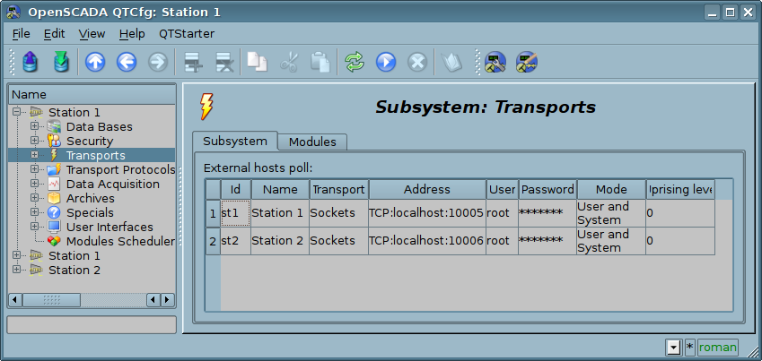

The "Subsystem" tab of the "Transports" subsystem. (68 Êá)
Fig. 13. The "Subsystem" tab of the "Transports" subsystem.
Äàëåå íà êîíêðåòíîé ñòàíöèè, ñ êîïèåé îáùåé ÁÄ, íàñòðàèâàåì å¸ ñïåöèôè÷åñêèå ïàðàìåòðû âî âêëàäêå "Ðåçåðâèðîâàíèå" ãëàâíîé ñòðàíèöû (ðèñ.14), êîòîðûå áóäóò ñîõðàíåíû â êîíôèãóðàöèîííîì ôàéëå.
Next for the concrete station, with copy of the generic DB, we configure its specific parameters into the tab "Redundancy" of the main page (Fig.14), which will be stored into the configuration file.

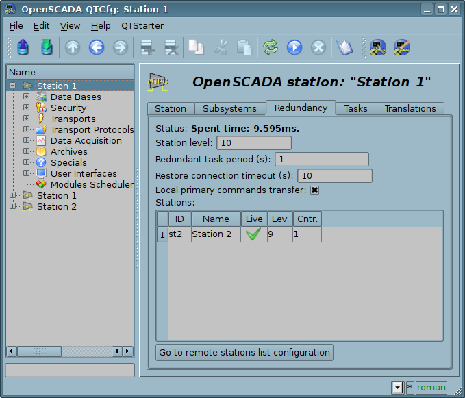

The "Redundance" tab of the main page. (77 Êá)
Fig. 14. The "Redundance" tab of the main page.

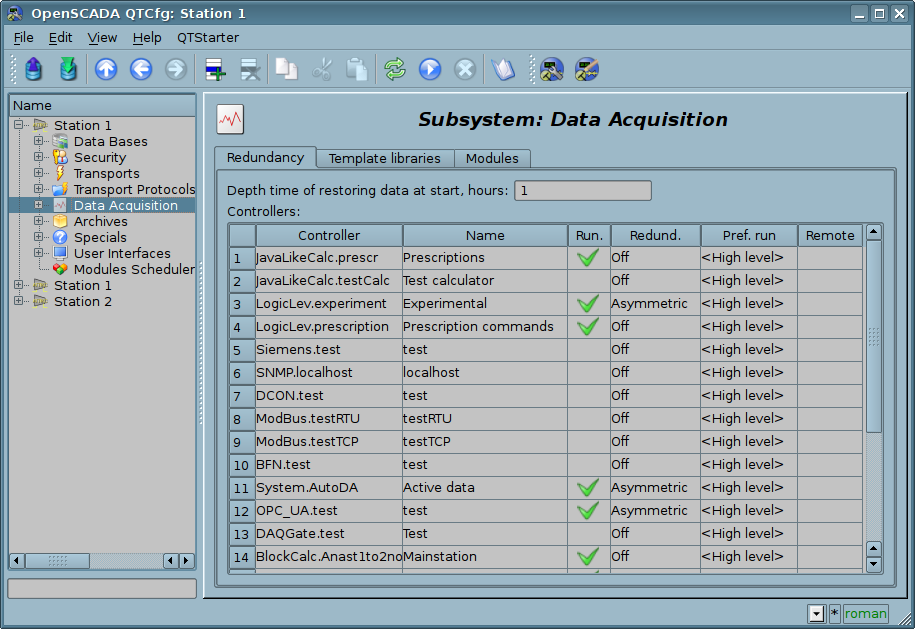

After that all next configurations of redundancy perform into the tab "Redundancy" of subsystem "Data Acquisition" (Fig.15), and if you will set the parameter "Local primary commands transfer" (Fig.14) then the configurations, like to any other generic configurations, can be performed at any one from the stations and all the performed changes will be transferred to all other ones, sure if its are available.
The "Redundance" tab of the "Data Acquisition" subsystem. (116 Êá)
Fig. 15. The "Redundance" tab of the "Data Acquisition" subsystem.
The service task of the redundancy mechanism is always running and executed at intervals which are prescribed in the appropriate configuration field. The real work on implementing the redundancy is carried out in the presence of at least one redundant station in the list of stations, and implies:
To monitor the time spent in the cycle of redundancy tasks the field status is provided. When approaching the real time of execution to the cycle of the redundancy tasks it's recommended to increase the frequency of execution of this task!
For the controller of subsystem "Data Acquisition" there is provided the modes of "Asymmetric" and "Only Alarms". Asymmetric redundancy is working with the configuration of the controller of the remote station, as it is, and does not trying to generalize it, and for it all early presented functions and properties of the redundancy work. The redundancy "Only Alarms" is working in fact without a redundancy, but with alarms oppressing from the reserve controller's object to exclude a duple messages into the alarms.
