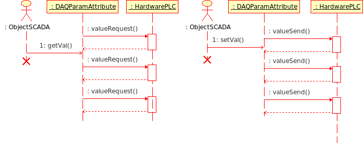

The mechanism is characterized by requests to the data source synchronously with the request to the attribute of parameter (Fig. 2). This mechanism is usually used when working with local sources of data, characterized by low latency, i.e. delay in response to the request. With this method you can get actual data directly with the request, but the time of the request of object will include the time for transportation and processing of the request by the data source.
 (10 Êá)
Fig. 2. Diagram of the sequence of interaction with the synchronous requests.
In accordance with the diagram above, we obtain the following sequence of requests for data acquisition and their transfer:

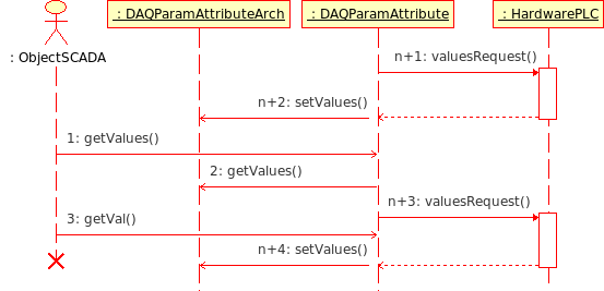

Package data acquisition mechanism is characterized by the acquisition of data for each signal by the packet that includes the history of its changes. I.e. per one session of data poll we obtain multiple values of history of the signal. The package mechanism works in conjunction with synchronous and asynchronous mechanisms.
In the case of working with a synchronous mechanism the actual transfer of the archive of data source for operational work in the system is done (Fig. 2). As the simple synchronous mechanism, it's desirable to apply only to low-latency data sources or to the sources whose work is a session type, for example, in the commercial account to read the values of the counters.
When working in conjunction with an asynchronous mechanism the history of the received signals is usually placed directly in the archives (Fig. 4), and the current value of the parameter's attribute is set to last value of the package. This combination is effective during the acquisition of the fast data or during the synchronization of the archives after the loss of connection to the remote data source.
 (16 Êá)
Fig. 4. Diagram of the sequence of interaction with the asynchronous requests of the package mechanism.
In accordance with the diagram above, we obtain the following behavior of the package mechanism for asynchronous requests:

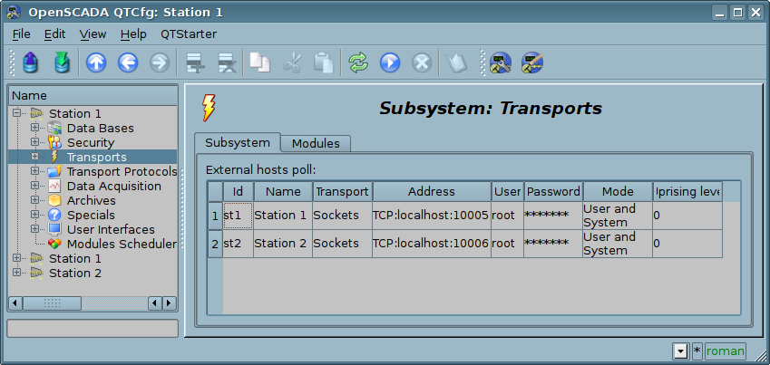

There is recommended the redundancy configure in way for DBs of the redundant stations save equal and that will allow you to copy its painlessly to each the station and then to backup only one the DBs set. And the configurations specified to the different stations will save into the configuration file and you can simply configure and change the needed station by the proper configuration file select.
The "Subsystem" tab of the "Transports" subsystem. (68 Êá)
Fig. 13. The "Subsystem" tab of the "Transports" subsystem.
