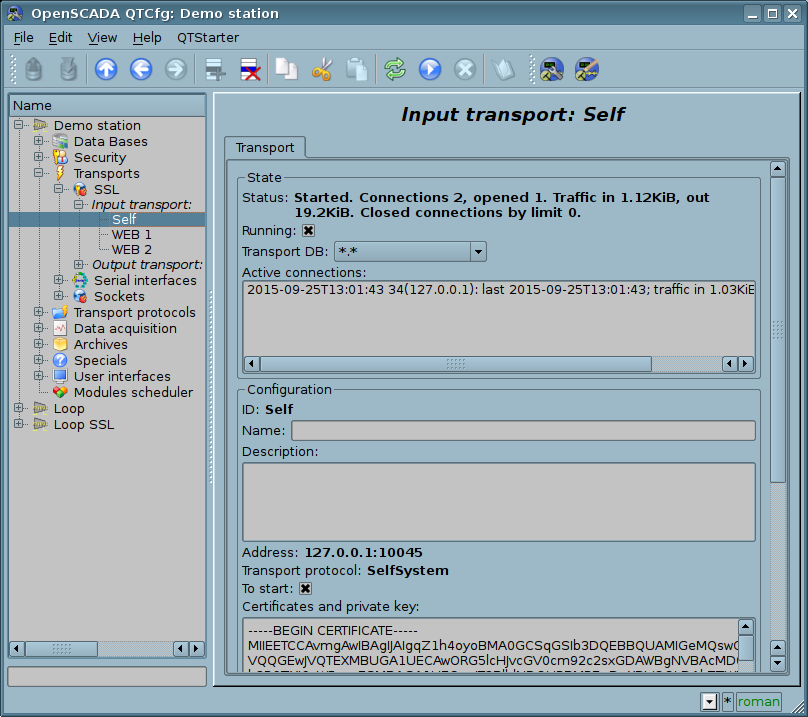

1. Incoming transports
The configured and running incoming transport opens server SSL-socket for the expectation of connection of the clients. SSL-socket is a multi-stream, ie when the client connects, the client SSL-connection and a new stream in which the client is served are created. Server SSL-socket in this moment switches to the waiting for the request from the new client. Thus the parallel service of the clients is achieved.
Each incoming transport is necessarily associated with one of the available transport protocols, to which incoming messages are transmitted. In conjunction with the transport protocol is supported by a mechanism of the combining of pieces of requests, disparate while transferring.
Configuration dialog of the incoming SSL-transport is depicted in Figure 1.
Configuration dialog of the incoming SSL-transport. (104 Kb)
Fig.1. Configuration dialog of the incoming SSL-transport.
Using this dialog you can set:

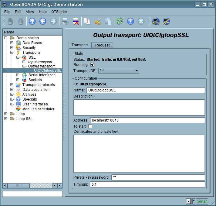

2. Outgoing transports
Configured and running outgoing transport opens the SSL connection to the specified server. In the case of destroying of the connection, outgoing transport is disconnected. In order to resume the connection transport must be re-run.
Main tab of the configuration page of outgoing SSL-transport is shown in Fig.2.
Main tab of the configuration page of the outgoing SSL-transport. (83 Kb)
Fig.2. Main tab of the configuration page of the outgoing SSL-transport.
