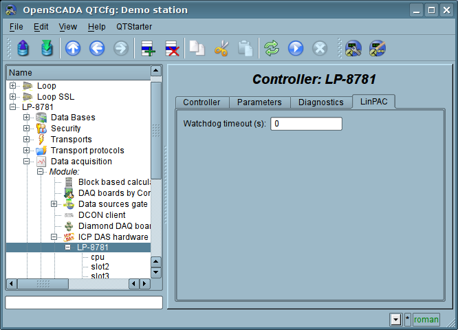

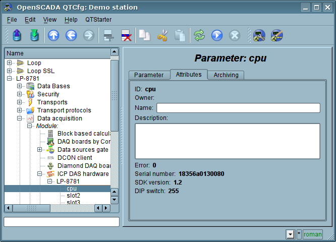

For common properties the controllers series LP-8xxx configuration allowed accordingly "LinPAC" tab on controller's page (Fig.4), and also by parameter "LP-8xxx" (Fig.5). Into parameter "LP-8xxx" you can get information about controller's serial number, SDK version, DIP and Rotary switch value. Into tab "LinPAC" you can set value for controller's watchdog timer. The watchdog timer is disabled by set it to zero value. Watchdog timer's value updated into controller's task and with it period, then the acquisition task hang consequently follow controller's restart! The watchdog value must be greater to the system full loading time, up to OpenSCADA loading, wherein OpenSCADA must be loaded after time sync start.
"LinPAC" tab for controllers LP-8xxx series configuration (58 )
Fig.4. "LinPAC" tab for controllers LP-8xxx series configuration
Parameter "LP-8xxx" attributes. (64 )
Fig.5. Parameter "LP-8xxx" attributes.

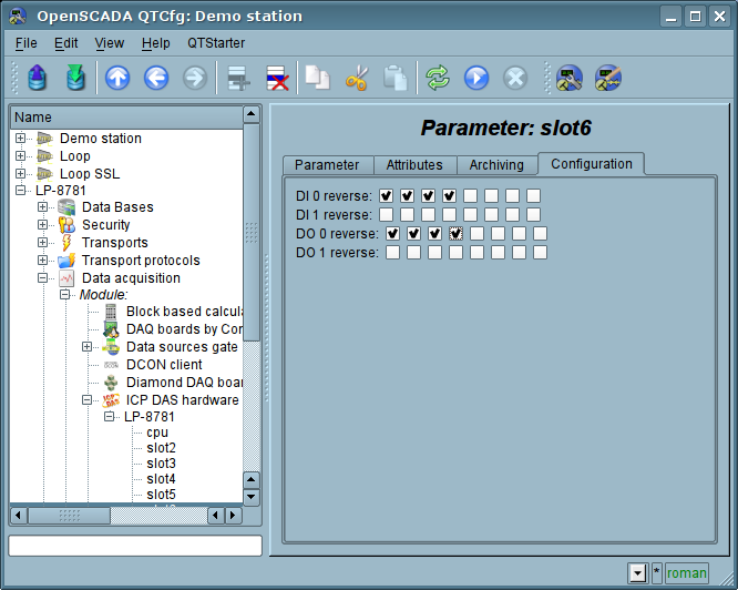

2.1.3 Digital input and output values inversion
For digital input and output modules, into tab "Configuration" (Fig.7), proposed selectable channel inversion function, that is too comfortably for next work with the channel.
Tab "Configuration" of module digital input and output (63 )
Fig.7. Tab "Configuration" of module digital input and output

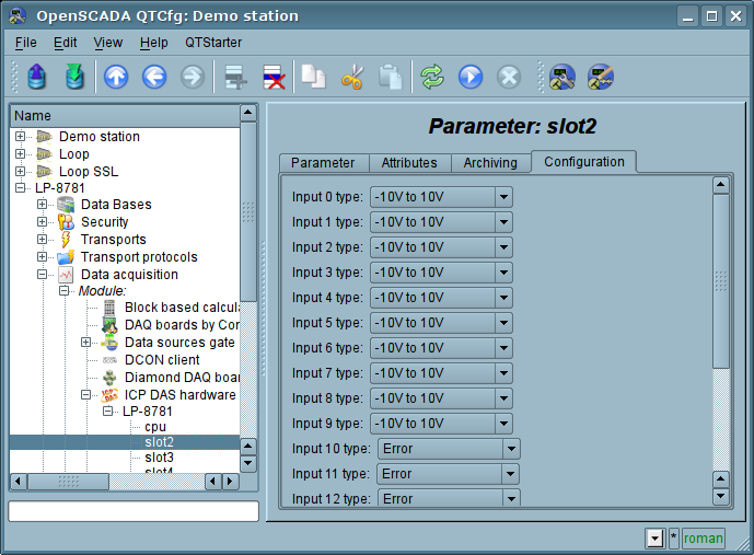

2.2.2 Channel type select for AI
For analog input modules possible to select mode/gain, which doing from list (Fig.9), if it specified for the module, or direct by mode's code set. The modes saved and stored into the module.
Tab "Configuration" of analog inputs module (89 )
Fig.9. Tab "Configuration" of analog inputs module

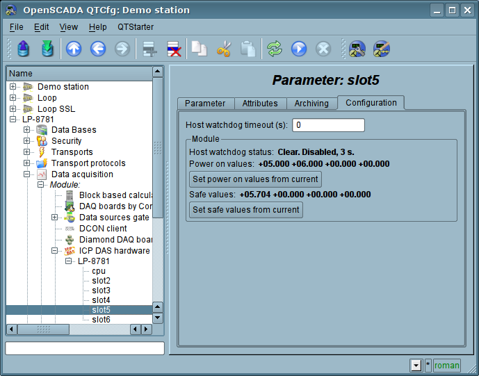

2.2.3 Host watchdog and default values for power on and by watchdog event
Modules with analog or digital outputs typical provide host watchdog function. And its sets safe outputs values on host activity miss for specified time. Also the modules allow specify outputs values for power on.
On Figure 10 presented tab for module with analog outputs and functions:
Tab "Configuration" of analog outputs module (79 )
Fig.10. Tab "Configuration" of analog outputs module
