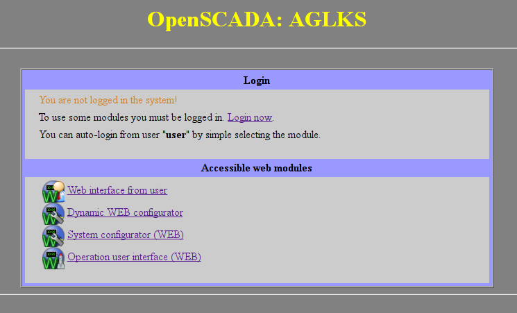

In the requests for the Web resources the URL(Universal Resource Locator) are commonly used, hence the URL is passed as the main parameter via HTTP. The first element of the requested URL is used to identify the module UI. For example URL "http://localhost:10002/WebCfg" means — address to module WebCfg on the host "http://localhost:10002". In the case of an incorrect indication of the module ID, or when you address without identifier of the module at all, HTTP module generates the dialogue of the information on the input and with the choice of one of the available user interfaces. Example of a dialogue is shown in Figure 1.
Dialog of the choice of WWW-interface module. (39 Êá)
Fig.1. Dialog of the choice of WWW-interface module.

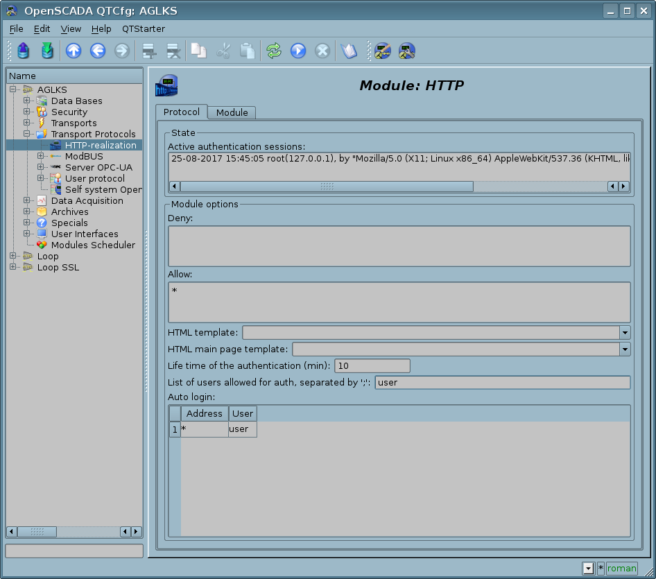

To configure and control of the module there allowed a configuration page of the control interface of OpenSCADA (Fig.3) where you can:
The module configuring page. (83 Êá)
Fig.3. The module configuring page.

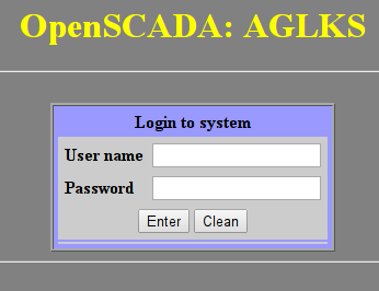

Module supports authentication in the system OpenSCADA while providing access to the WEB-interface modules (Fig.2).
Authentication dialogue in the system OpenSCADA. (11 Êá)
Fig.2. Authentication dialogue in the system OpenSCADA.
For ease of working with Web-based interfaces the module provides an ability to automatically log on from name of the specified user. Configuring for the automatic login makes by the module settings page (Fig.3). Automatic login performs by matching the address indicated in the column "Address", on behalf of the user specified in the column "User".
For more security you can set only Web users into the list of users allowed for authentication.
