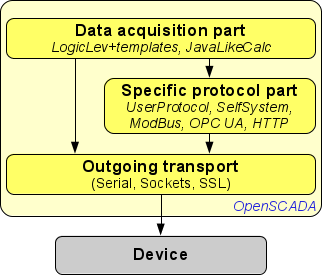

In general the custom accessing conception to the device's data we can imagine like to figure 1.
Custom accessing to device's data conception. (21 Кб)
Fig.1. Custom accessing to device's data conception.
As you can see from image 1 intermediate to the device carried out through some transport by the device physical base. Requests to the transport you can send:
For placing here a protocol you need do next and follow to shown demands:
