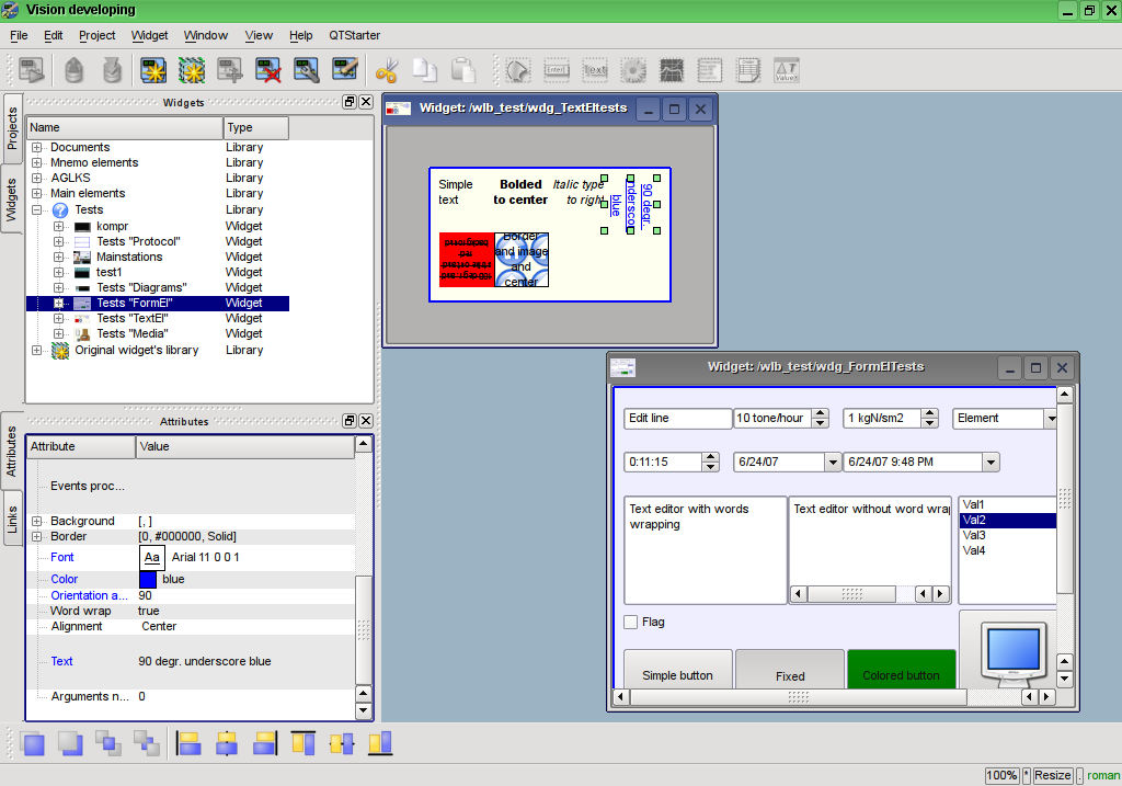

Implementation of basic functions of the development framework of the user interface in the presentation(visualization) module UI.Vision
Framework of the user interfaces' development of the module based on MDI (Multi Document Interface) interface. This approach allows you to simultaneously edit multiple frames of various sizes. Following arrangements for managing the development are used: the toolbar, menu and context menu. Most actions are duplicated in the different mechanisms, so you can quickly find the tool by the preferred method. Navigation interfaces are implemented by the attachable windows. The configuration of toolbars and attachable windows are saved on exit and restored at startup that lets you to configure the interface for yourself.
One of the elements of the user interface, implemented as the attachable window is a browser of the widget's library. With the browser you can quickly find the widget or the library and do the necessary operations on them. The following operations are implemented: addition, deleting, configuration of widgets and libraries, as well as visual editing of the widget.
For easy management of the properties of widgets/frames the inspector of attributes(properties) of widgets is implemented. Inspector of the attributes is implemented as the attachable window, which is activated when you select the frame or widget. Window of the inspector of attributes can be conveniently positioned by attaching it to one of sides of the working window. Inspector of attributes supports the group configuration of several widgets, as well as grouping of similar properties.
For visual editing of the frames the primary support for editing of widgets and frames is implemented. Even now the editor allow you to edit the frames, based on the primitive Box, and the text field primitive "Text" full-featured display. In the editor the following functions are implemented:
Development window is shown in Fig. 6.1.1, where you can see: the toolbar, navigator of widgets, inspector of attributes, editing window of the frame and status bar.

Fig.6.1.1 Development window of the UI.Vision module

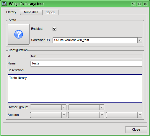

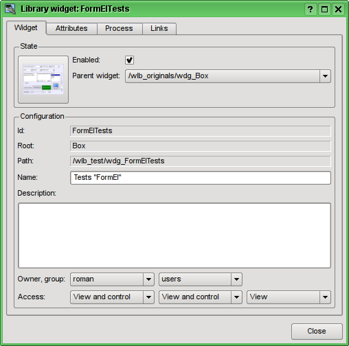

To configure the widgets' objects and their libraries two dialogues are implemented: the dialogue of the widget's configuration (Fig.6.1.2) and the configuration dialog of the widget's library configuration (Fig.6.1.3). The library configuration dialog allows you to set the basic properties of the library and put the mime-data in the database for subsequent using in the widgets of the library. Widget's configuration dialog allows you to set: basic properties of the widget, individually to set the values of attributes and configure the internal procedure for computing the widget with additional(user's) properties.
 (25 Κα)
Fig.6.1.2 Dialog of the widget's library configuration.
 (32 Κα)
Fig.6.1.3 Dialog of the widget's configuration.
