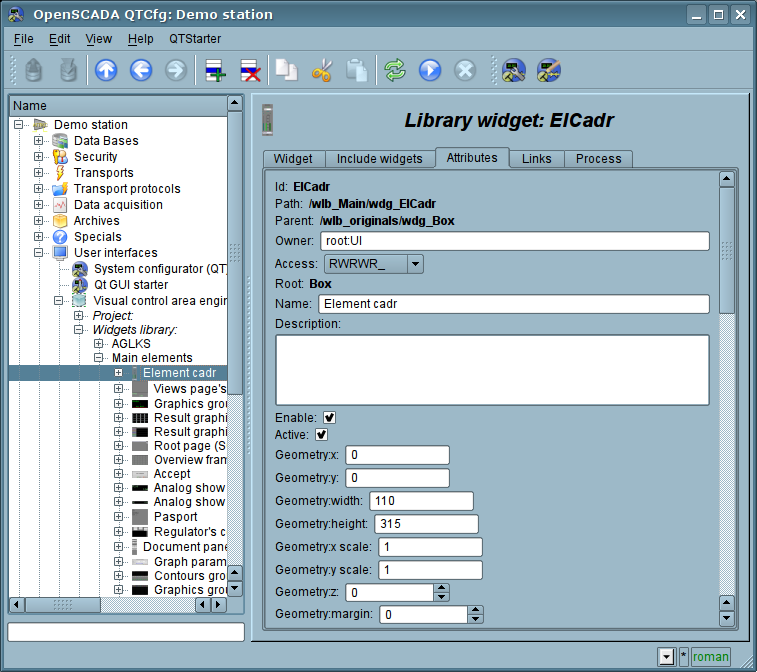

id Id - Id of the element. The attribute is read-only, designed to provide information on the ID of the element.
path Path - The path to the widget. The attribute is read-only and designed to provide full information about the location of the element.
parent Parent - Path to the parent widget. The attribute is read-only and designed to provide information about the location of ancestor which the widget is inherited from.
owner Owner - The widget owner and group in form "{owner}:{group}", by default the "root:UI".
perm Permission -
Permission to the widget in form "{user}{group}{other}" plus inheritance flag, includes the inheritance owner and it's permissions from upper widget.
Where "user", "group" and "other" is:
  • "__" — no any access;
  • "R_" — read-only;
  • "RW" — read and write.
By default the 01000(inheritance).
root Root 1 Id of the widget-primitive (basic element) which underlies the image of visualization of the widget.
name Name - Name of the element. Modifiable the element name.
dscr Description - Description of the element. Text field, serves for attachment to the widget of the brief description.
en Enabled 5 The state of the element — "Enabled". Disabled element is not shown in the execution mode.
active Active 6 The state of the element — "Active". Active element may receive focus in the execution mode, and thus receive keyboard and other events with their subsequent processing.
geomX Geometry:x 7 Geometry, coordinate 'x' of the element position.
geomY Geometry:y 8 Geometry, coordinate 'y' of the element position.
geomW Geometry:width 9 Geometry, the width of the element.
geomH Geometry:height 10 Geometry, the height of the element.
geomXsc Geometry:x scale 13 The horizontally scale of the element.
geomYsc Geometry:y scale 14 The vertical scale of the element.
geomZ Geometry:z 11 Geometry, coordinate 'z' (level) of element on the page. It also defines order to transfer the focus through active elements.
geomMargin Geometry:margin 12 Geometry, the margins of the element.
tipTool Tip:tool 15 The text of a brief help or tip on this element. Usually is realized as a tool tip, while keeping your mouse cursor over the element.
tipStatus Tip:status 16 Text information on the status of the element or the guide to action over the element. Usually is implemented in the form of a message in the status bar while keeping your mouse cursor over the element.
* Modification from session of the attribute of the root page will record the message in the status bar of the visualization window session.
