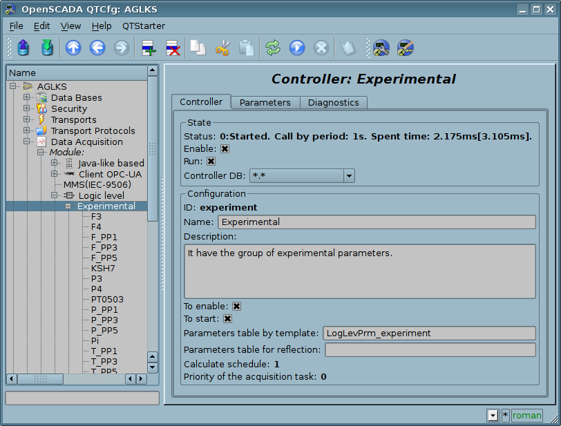

For addition of the data source of parameters of the logical level the controller in the system OpenSCADA is created and configured. Example of the configuration tab of the controller of the type is depicted in Figure 1.
Configuration tab of the controller. (89 Êá)
Fig.1. Configuration tab of the controller.

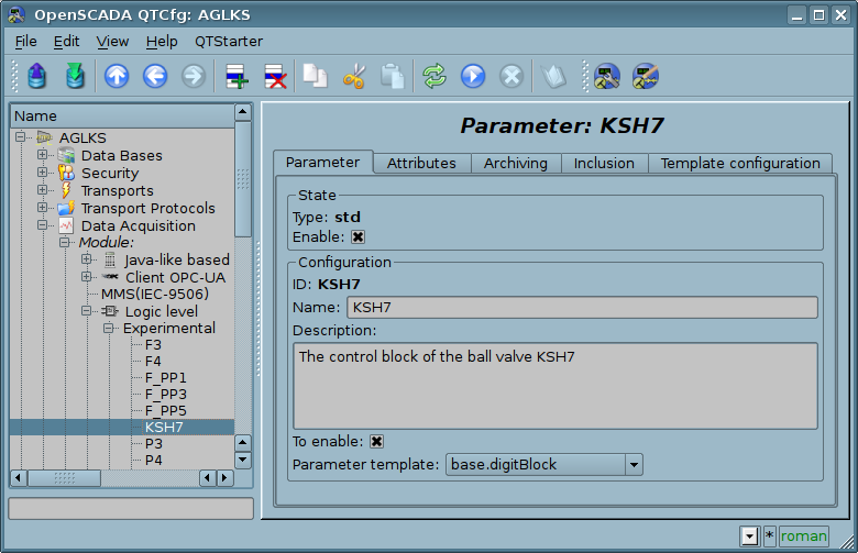

The LogicLev module provides two types of parameters: "Logical"(std) and "Reflection parameter"(pRefl). Additional configuration fields, the parameters of the module (Fig. 2) are:
Configuration tab of the parameter. (73 Êá)
Fig.2. Configuration tab of the parameter.

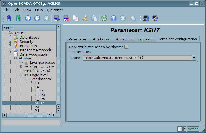

This record allows to group multiple attributes of a source parameter and assign them only by the choice of the parameter. Ie in the configuration dialog of the template (Fig. 3)it will be shown only parameter. This does not preclude the possibility to assign the attributes of the parameter each separately, in addition, if you miss in the configuration of the template the description of the links in the specified format, it will be assigned an attribute of the parameter (Fig.4).
The module provides a special treatment of a number of attributes of the template:
Sign "(+)" at the end of the address signals about successful linking and presence of the target. For object's type attributes allowed hierarchical access to the object concrete property by set the path through symbol '#', for example: "LogicLev.experiment.Pi.var#pr1.pr2".
Configuration tab of the template of parameter. (66 Êá)
Fig.3. Configuration tab of the template of parameter.

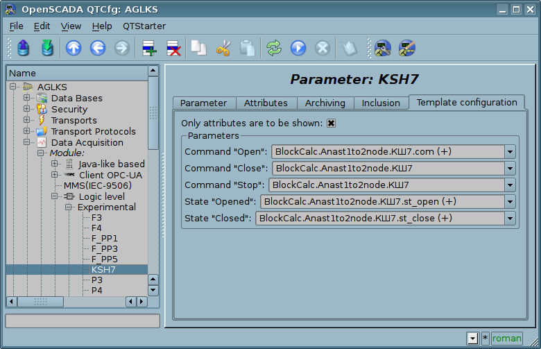

Configuration tab of the template of parameter. Show only attributes. (82 Êá)
Fig.4. Configuration tab of the template of parameter. Show only attributes.
