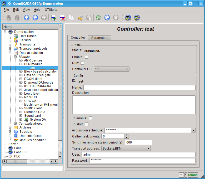

For addition of the data source the controller is created and configured in the OpenSCADA system. Example of the configuration tab of the controller is depicted in Figure 2.
Configuration tab of the controller. (112 Êá)
Fig.2. Configuration tab of the controller.
From this tab you can set:
