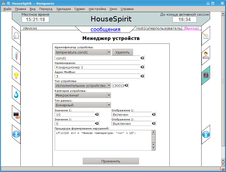

2.2. Devices Manager
The Devices Manager is available only for root and builds the form (Fig. 2) for edit, and and remove devices of two types: binary and decimal.
Fig. 2. Devices Manager.
The created device are placed in the attributes list of the parameter of the specifically taken subsystem of "ZigBee" controller of the data source module ModBus (/sub_DAQ/mod_ModBus/cntr_ZegBee/). Recording format of an attribute is as follows:
In addition to direct sensors the configuration and formation of alarms is made in the form of text procedure. The program of formation is placed in the "var" attribute of the alarms controller parameter /sub_DAQ/mod_JavaLikeCalc/cntr_alarms/prm_rules.
The "var" attribute contains the following XML tree:
<ALARMS>
  <it id = "temperature.cond1">
    if(x&lt;10) err = &quot;Low temperature: &quot;+x+&quot; &lt; 10&quot;;
  </it>
</ALARMS>
According to the XML-tree the formation of alarms and sending SMS-notifications to the subscribed users is made in the controller's task /sub_DAQ/mod_JavaLikeCalc/cntr_alarms, which is executed with a period of 1 minute.
SMS-notifications are sent via the serial transport /sub_Transport/mod_Serial/out_GSM and through the user's SMS-protocol (/sub_Protocol/mod_UserProtocol/up_SMS).
You can also select the delayed giving of the control action. To do this, the user sets the right time, in the form of: {Min}:{Sec}. Processing of the delayed control is made in the controller /sub_DAQ/mod_JavaLikeCalc/cntr_timers by setting the "var" attribute of the "rules" parameter with the help of requests in the XML tree:
<TIMERS>
  <timer id="temperature.tGhost1" tm="60" user="root">20</timer>
  <timer id="temperature.cond1" tm="10" user="root">0</timer>
</TIMERS>

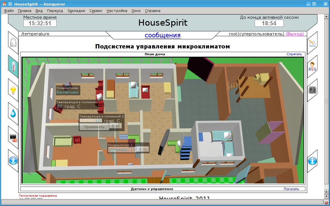

2.3. Subsystems
All visualization subsystems are served by the /sub_DAQ/mod_JavaLikeCalc/lib_web/devMon script. This script process the requests from the script of the dynamic visualization of Web-browser and receive the data on the subsystem's devices, required for visualization (Fig. 3). Data about the devices are transferred in accordance with the privileges of the logged user.
Fig. 3. Subsystem's management.
The configuration of sensors is read from the parameter corresponding to the "ZigBee" controller's subsystem (/sub_DAQ/mod_ModBus/cntr_ZegBee). The values ​​are read and written to the attributes of the sensors of these parameters or through the controller or delayed management.
The task of the "ZigBee" controller is executed with the period of 1 second, in the process of which the request of the the current values ​​of all configured sensors is made. Record of the the values ​​is made on the fact of modification, regardless of the periodic polling task or through the delayed management controller in the case of installation of nonzero timer.
Connection to the "ZigBee" controller is made via serial outgoing transport /sub_Transport/mod_Serial/out_ZegBee.

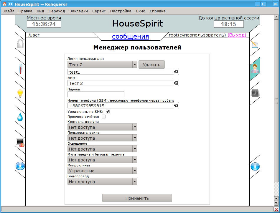

2.4. Users manager
Users manager (Fig. 4) is intended to create, delete and edit accounts of ordinary users.
Fig. 4. Users manager.
Users are divided into administrators and ordinary users. Identification of the user as an administrator in the OpenSCADA system is made by turning it into the "WebRoot" group (/sub_Security/grp_WebRoot). An ordinary user is included into the "Web" group (/sub_Security/grp_Web).
In OpenSCADA system, each user (/sub_Security/usr_test1/) has a text description field, which in this case serves to store its special settings in the following way:
TEL: +380679859815
SMS: true
Report: false
sub_access: --
sub_friend: --
sub_light: --
sub_tech: --
sub_temperature: rw
sub_water: --
In the case of an administrator's account the records of an access rights to the subsystems are not available, but there are system-wide settings such as the lifetime of the session (/sub_Protocol/mod_HTTP).
