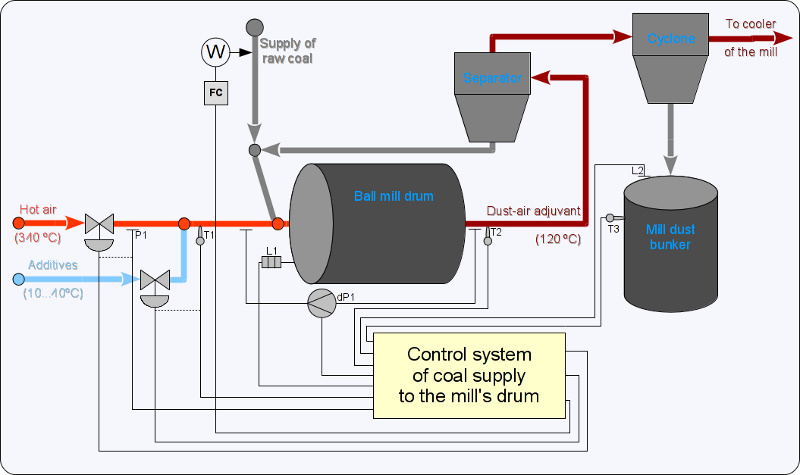

The dust preparation process includes: department of the coals preparation, the coals transporter to bunker of ball mills (SRC-Supply Raw Coal), two ball mills and the dust bunker. Subject of the project is automatic control of process of loading of the ball drum mills depends from their mode and load.
The company uses ball drum mills "BDM 287\410 PT". Functional scheme of a ball mill with the automation components is shown in Figure 1.
Functional scheme of a ball mill. (80 Кб)
Fig. 1. Functional scheme of a ball mill.

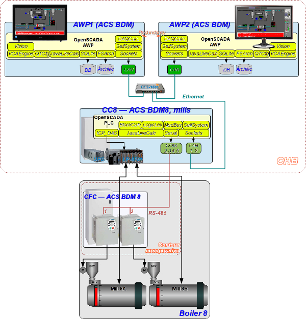

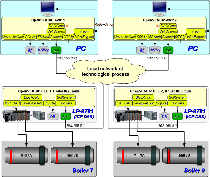

Structural scheme of the ACS of mills of single boiler (K8) is shown on the Figure 2, and Figure 3 (as a part of DIYA Ltd automation solutions and the common network), it is contains this nodes: two cabinets by controller CC 7, 8, 9 (on CHB — Central Heat Billboard) and CFC (into nonoperative contour of boiler 7, 8, 9); and the stations of automation workplace of operator AWP1 and AWP2.
Structural scheme of the ACS. (177 Кб)
Ðèñ. 2. Structural scheme of the ACS.
Ðèñ. 3. Structural scheme of the ACS as a part of DIYA Ltd automation solutions and the common network.
In accordance to the structure above the ACS contains the object of automation — mills, controllers of the mills control (CC 7, 8 and 9), frequency converters (CFC 7, 8 and 9), and two automation workplaces (AWP 1 and AWP 2). Each of the controller of ACS BDM independent controls by mills of the concrete boiler. Then the controller CC7 manages by mills of the boiler 7, CC8 — by mills of the boiler 8, and CC9 — of the boiler 9. Link to the frequency converters (FC) performs exclusively by physical signals, for ACS BDM 7 and 9, and also by an interface channel RS-485 by protocol ModBus/RTU, in case of ACS BDM 8.
The technological process data are concentrated and presented on AWPs. Each workplace presents the TP (Technological Process) data of all boilers. With each other workplaces are connected in redundant scheme that prevents data loss at the time of stopping one of the workstations. In order to optimize the load on the controller the real acquisition of the controllers makes only one workplace, while another one is receiving data from the main one. The main workplace is "AWP 1", which performs a direct acquisition of the controllers. In case of failure of the "AWP 1" the controller's acquisition performs "AWP 2", and makes it until the restoration of an "AWP 1". In the process of restoration after failure of the workplace the synchronization of archives depths up to 1 hour is made. Restoration of the archives for the longer time interval is made simultaneously with access to these archives. Addition ACS "Continuous venting" data sown on the AWPs (CC4).
All the nodes of ACS BDM connected to network ACS BDM, into self masc, which physically has an enter to the factory network.
In process of implementing ACS BDM 8 (year 2015) there was been updated PLC ACS BDM 7, 9 in point of the algorithms unification, errors fixing and optimization. Also there was been replaced to new the main AWP 1, represents as a monoblock PC. AWPs' program environment was full updated, and the project of SCADA-system was appended.

2016-04-03 20:15:44    (31 Kb)  ballmill.odg Diagram: Functional scheme of a ball mill.
2016-04-03 21:26:26    (80 Kb)  ballmill.png Functional scheme of a ball mill.
2016-04-03 20:46:48    (443 Kb)  ballmill_sau.odg Diagram: Structural scheme of the ACS.
2016-04-03 20:46:13    (177 Kb)  ballmill_sau.png Structural scheme of the ACS.
2016-04-03 21:18:45    (1176 Kb)  diya_sau.odg Diagram: Structural scheme of the ACS as a part of DIYA Ltd automation solutions and the common network.
2016-04-03 21:18:13    (567 Kb)  diya_sau.png Structural scheme of the ACS as a part of DIYA Ltd automation solutions and the common network.
2010-09-23 11:21:30    (148 Kb)  kramatorsk_asutp.odg Diagram: Structure scheme of the ACS TP.
2010-09-23 11:21:01    (117 Kb)  kramatorsk_asutp.png Structure scheme of the ACS TP.
