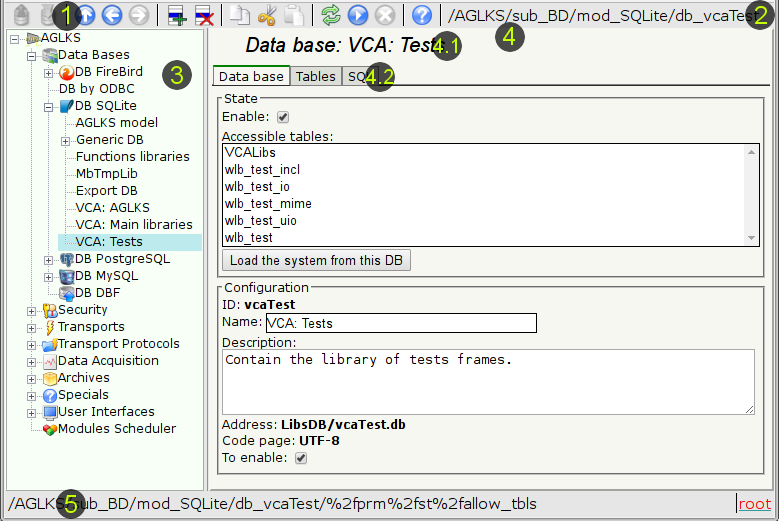

Lets examine the working window of the configurator in Fig. 2.
Working window of the configurator consists of the following parts:
1 Toolbar — contains the control buttons.
2 Address of the open node — displays the current selected node.
3 Navigator — intended for direct navigation through the control tree.
4 Working field — divided into parts:
4.1 The name of the node — contains the name of the current node.
4.2 Tabulator of the working areas — the root pages (control areas) of the node are placed into the tabulator. The control areas of the following levels are placed on the information panel.
5 Status line — displaying the states of the configurator.

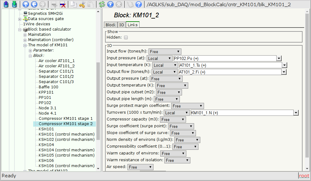

2. Basic elements
Into the number of the basic elements are included: information elements, the field to input values, the elements of choice from the list, flags. In the case of absence of an element name, the basic element connects to the previous basic element. Example of the group of the basic elements with the connection is shown in Fig.4.
For input elements that do not mean instant change and may be edited for a long time before a final conclusion, a confirmation mechanism is foretold. This mechanism eliminates the delay when editing, especially in the case of the configuration of remote stations, and to make changes on the confirmation. To elements of input with confirmation include: input line fields of text or numeric values and text fields. Confirmation is made by pressing the button that appears next to the input field after the start of editing.
Connection of the basic elements. (108 Êá)

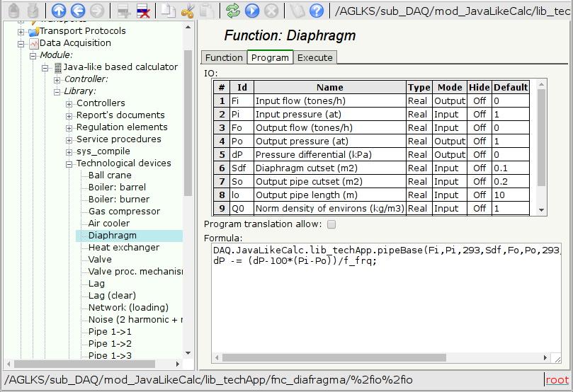

4. Lists
Lists contain a group of basic elements of the same type. Operations under the elements are accessible via the context menu by the mouse click on the list. Through the elements of the list can be performed the moving operations to other pages. Lists can be indexed. An example of the list is shown in Fig. 6.
The list. (45 Êá)

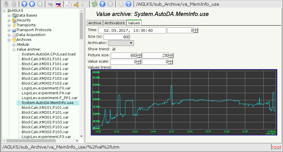

6. Images
The images are designed to transmit graphic information into the configurators. Example of the image is shown in Fig. 8.
The image. (98 Êá)
