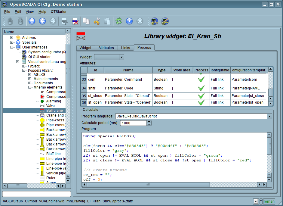

In terms of the VCA, the dynamic links and configuration of the dynamics are the one process, to describe a configuration of which the tab "Processing" of the widgets is provided. The tab contains a table of configuration of the properties of the attributes of the widget and the text of calculation procedure of the widget.
The tab "Processing" of the configuration page of the widget. (131 Κα)
Figure. The tab "Processing" of the configuration page of the widget.
In addition to configuration fields of the attributes the column "Processing" in the table provides, for selective using of the attributes of the widgets in the computational procedure of the widget, and the columns "Configuration", "Configuration template", to describe the configuration of links.

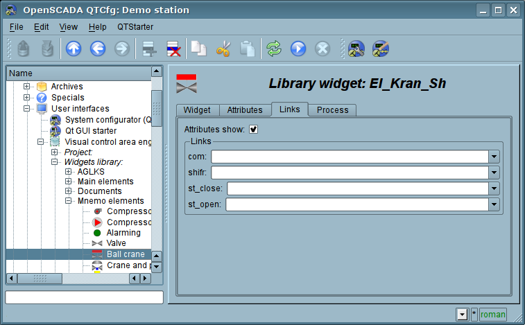

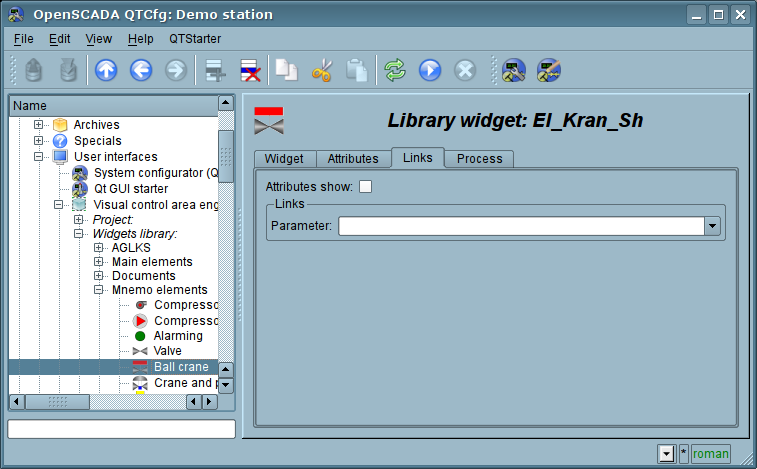

In the Figure the tab of links with the group assignment of the attributes by the only specifying the parameter is presented, and in next Figure — with the individual appointment of the attributes.
Tab "Links" of the page of configuration of the container of widgets, including widgets with links. (66 Κα)
Figure. Tab "Links" of the page of configuration of the widget with the group assignment of the attributes by the only specifying of the parameter.
Tab "Links" of the page of configuration of the container of widgets, including widgets with links. (69 Κα)
Figure. Tab "Links" of the page of configuration of the widget with the individual appointment of the attributes.

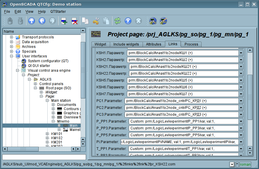

When the widget that contains the configuration of links is placed to the container of widgets, all links of the source widget is added to the list of resulting links of the widgets' container, but only to a depth of one level of nesting.
Tab "Links" of the page of configuration of the container of widgets, including widgets with links. (140 Κα)
Figure. Tab "Links" of the page of configuration of the container of widgets, including widgets with links.
