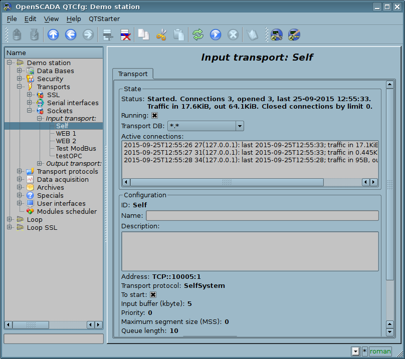

Configuration dialog of the incoming socket is depicted in Figure 1.
Configuration dialog of the incoming socket. (105 Êá)
Fig.1. Configuration dialog of the incoming socket.
Using this dialog you can set:
 (2 Kb) Empty value for the protocol selection switch the transport to mode of creation associated output transports for each connection to the input transport.
The associated output transports mode for the input transport demands allowing some external for the transport procedure which serve as the protocol which must go through all associated output transports, and do requests to read or write-read.
 (2 Kb) The procedure missing will necessarily come to growing the associated output transports by miss an essence causes the closed connection transport stopping and next allowing for remove the stopped output transports by the input transport.
 (2 Kb) We do not recommend disable the function by the TCP/IP network's properties does not guarantee notice the server about the connection disable, for example after power supply lost on the client. As result the opened client connections will left forever and after its number achieve to the limit server will drop new connections!
