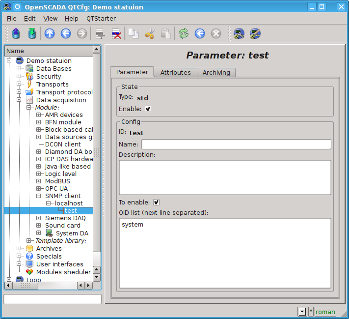

From this tab you can set:
2.2. Parameters
Module SNMP provides only one type of parameters — "Standard". An additional configuration field of the parameter of the module(Fig. 2) is a list of MIB-parameters, the branches or separated items (scalars) of which are to be read.
Configuration tab of the parameter. (96 Êá)
Fig.2. Configuration tab of the parameter.

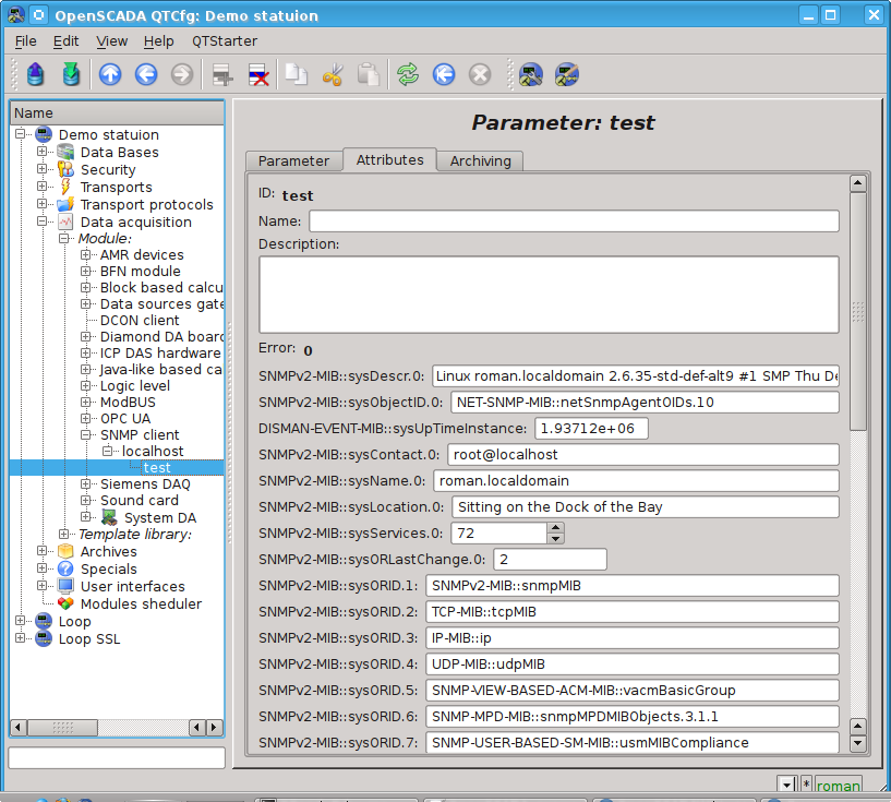

In accordance with a specified list of MIB-parameters is carried out a survey of their branches (or scalars) and the creation of the attributes of the parameter. Further, updating of the values of parameters is carried out. Attributes are named in accordance with the code addressing of MIB-parameters, as the ID, and the addressing from the base of MIB objects in the name of the attribute(Figure 3).
Fig.3. Tab of the attributes of the parameter.
