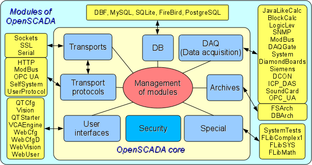

The block scheme of OpenSCADA system (74 Κα)
Fig. 1. The block scheme of OpenSCADA system
1.1. Modularity.
In order to achieve flexibility and a high degree of scalability OpenSCADA is constructed in a modular fashion. The process of developing our own modules imposed a great risk; possible errors could introduce an element of instability into the system, however tight integration of the modules with kernel lessened this issue and the ability to create a distributed configuration was seen as a greater benefit. In the end a more flexible and stable system was created.
OpenSCADA modules are stored within dynamic libraries and each shared library can contain modules of various types. The specific functional modules that are contained in a library is determined by the specifics of the modules connections. These dynamic libraries are hot swappable, which allows for the updating of a specific module without affecting the system as a whole. This method of storing code modules in dynamic libraries is essential for OpenSCADA, because it is supported by virtually all modern operating systems (OS). However, this does not exclude the possibility of developing other methods of storing code modules.
OpenSCADA has the following functional parts or modules:
Management of the modules is carried out by the "Modules Management" subsystem, whose functions include connection, switching off, updating, and other operations concerned with the management of the modules and their libraries.
1.2. Subsystems.
Architecturally OpenSCADA is divided into subsystems or two types, regular and modular. Modular subsystem have the ability to expand through the addition of modules, with each modular subsystem containing sets of modular objects. For example the modular Database subsystem contains modular objects of the database type, thus the modular object is the root of the module.
The basic configuration of OpenSCADA consists of nine subsystems with seven being modular. These nine subsystems are present at every configuration. Additional subsystems can be created by adding additional modules. The following lists the basic subsystems of OpenSCADA:
