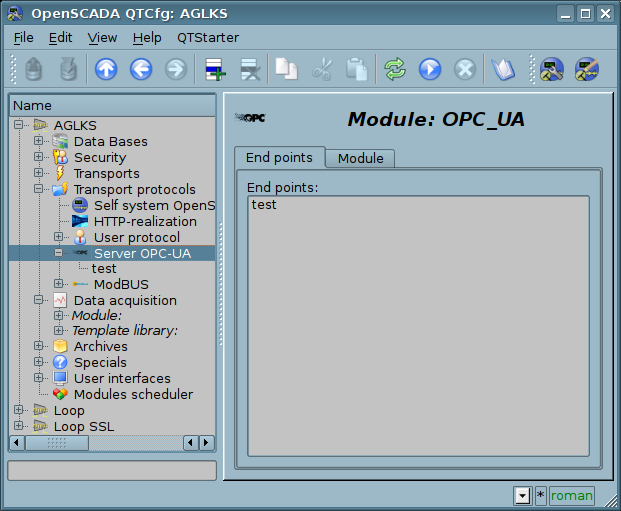

Incoming requests to the module-protocol are processed by the module in accordance with configured endpoint nodes of OPC-UA (EndPoints) (Fig. 1).
Endpoint nodes of the protocol. (62 Źį)
Fig.1. Endpoint nodes of the protocol.

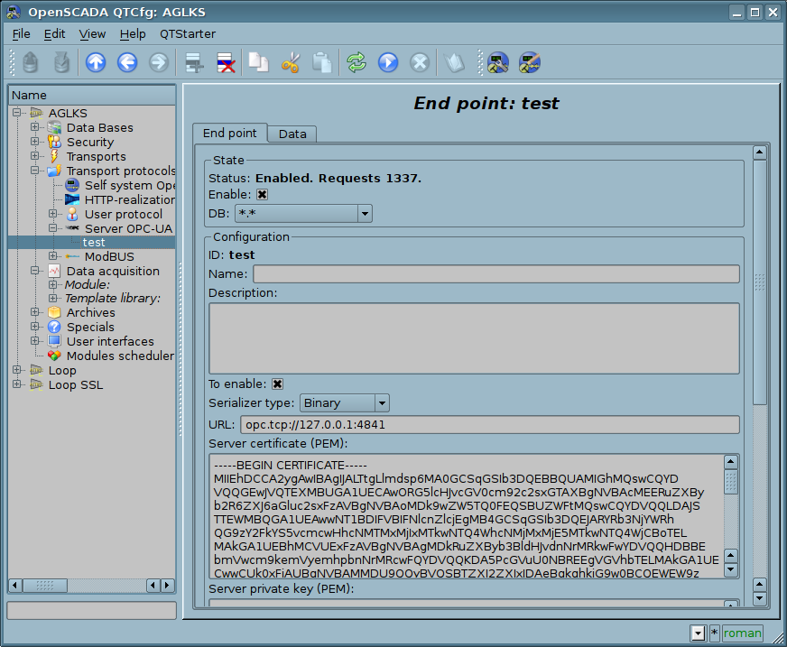

The endpoint node of the OPC-UA protocol is actually the server object of OPC-UA. Endpoint nodes in OPC-UA can be either local or remote. The local one is designed to provide resources of OpenSCADA station to protocol OPC-UA, while the remote endpoint nodes are both for the service and review of available OPC-UA units, and to forwarding of the requests to remote stations. In this version of the module is only supported the configuration of the local endpoint nodes.
General configuration of the endpoint node is made on the main tab of the endpoint node's page (Fig. 2) with parameters:
Main tab of the endpoint node's page. (129 Źį)
Fig.2. Main tab of the endpoint node's page.

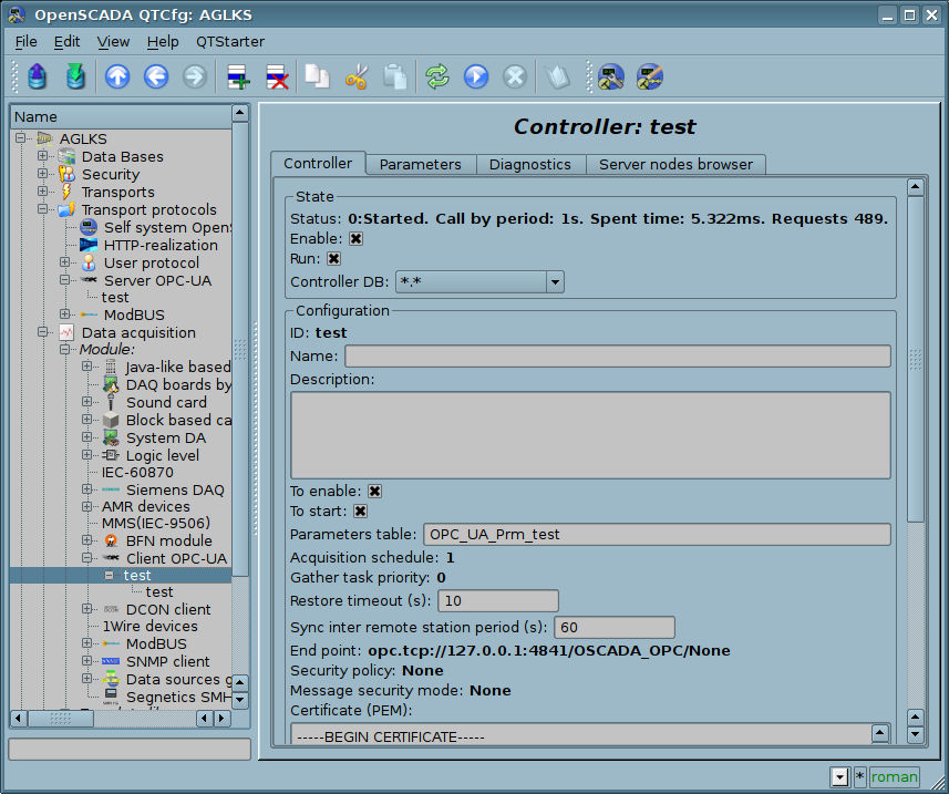

To append the OPC-UA data source the controller's object into the OpenSCADA system is created and configured. An example of the configuration tab of the controller's object is shown in Figure 3.
Controller's object configuration tab. (129 Źį)
Fig.3. Controller's object configuration tab.
From this tab you can set:

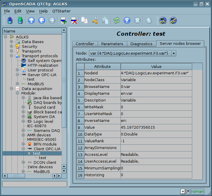

 (2 Kb) Often there meets a situation when the refined address is symbolic which does not resolve into the network by the server incorrect configuration. In this cases you need to keep the original IP-address or the name which resolved to the correct IP.
To facilitate the identification of nodes on the remote station, as well as their choice to be inserted in the parameter of the controller in the controller's object it is provided the navigation on the remote station's nodes tab, where you can walk through the tree of objects and familiar with their attributes (Figure 4).
The "Server nodes browser" tab of the controller's object page. (117 Źį)
Fig.4. The "Server nodes browser" tab of the controller's object page.

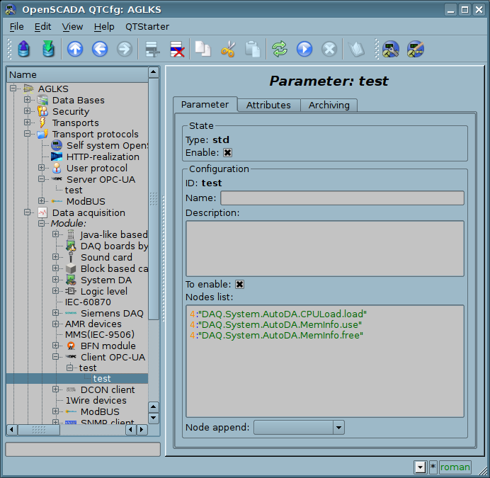

The data acquisition module provides only one type of parameters — "Standard". Additional configuration field of the parameter of the module (Fig. 5) is the list of OPC-UA nodes and the field of navigation by OPC-UA nodes in single line, for the selected nodes of type "Variable" insertion to the defined list. Attribute in this list is written as follows: {ns}:{id}.
Where:
ns — name space, number; zero value can be omitted;
id — node identifier by number, string, bytes string and GUID.
Examples:
84 — root directory;
3:"BasicDevices2" — basic devices node in the name space 3 and the string view;
4:"61626364" — node in the names space 4 and the byte string view;
4:{40d95ab0-50d6-46d3-bffd-f55639b853d4} — node in the names space 4 and the GUID view.
Configuration tab of the parameter's object. (97 Źį)
Fig.5. Configuration tab of the parameter's object.

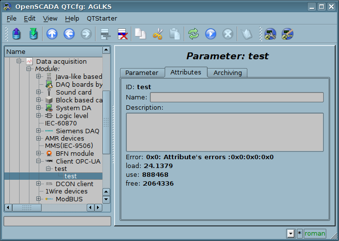

In accordance with the specified list of nodes performs acquisition and creation of the parameter's attributes (Fig. 6).
The parameter's attributes tab. (72 Źį)
Fig.6. The parameter's attributes tab.
