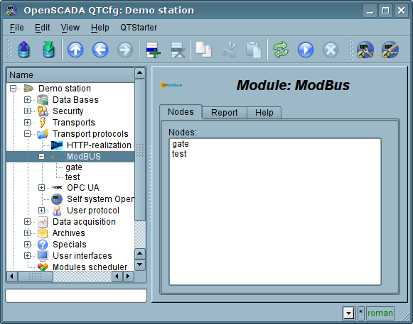

2.2. Servicing of the requests for ModBus protocol
Input part of servicing of the requests to the module of the protocol realizes verification and processing of the requests through objects of the nodes, provided by the module(Fig. 1). Actually, the mechanism is implemented, that allow the system OpenSCADA to perform the role of the ModBus/TCP server or the slave device of ModBus/RTU and ModBus/ASCII. Thus the system OpenSCADA gets an opportunity to serve the role of any participant of the ModBus networks.
Tab of the list of the nodes of servicing incoming requests of the protocol. (55 Êá)
Fig.1. Tab of the list of the nodes of servicing incoming requests of the protocol.

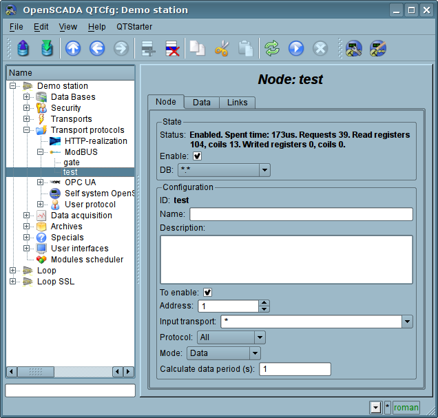

The node of the protocol is equivalent to the physical node of the device of ModBus network. Node of the protocol can operate in three modes:
Since the protocol nodes can be created a great number, it turns out that on the one interface, ie in the one network, one station on the basis of OpenSCADA can clear provide multiple nodes of ModBus network with different data.
Lets consider particular configuration of the node of the protocol in various modes.

The tab "Node" of the configuration page of the node of the protocol in the "Data" mode. (74 Êá)
Fig.2. The tab "Node" of the configuration page of the node of the protocol in the "Data" mode.

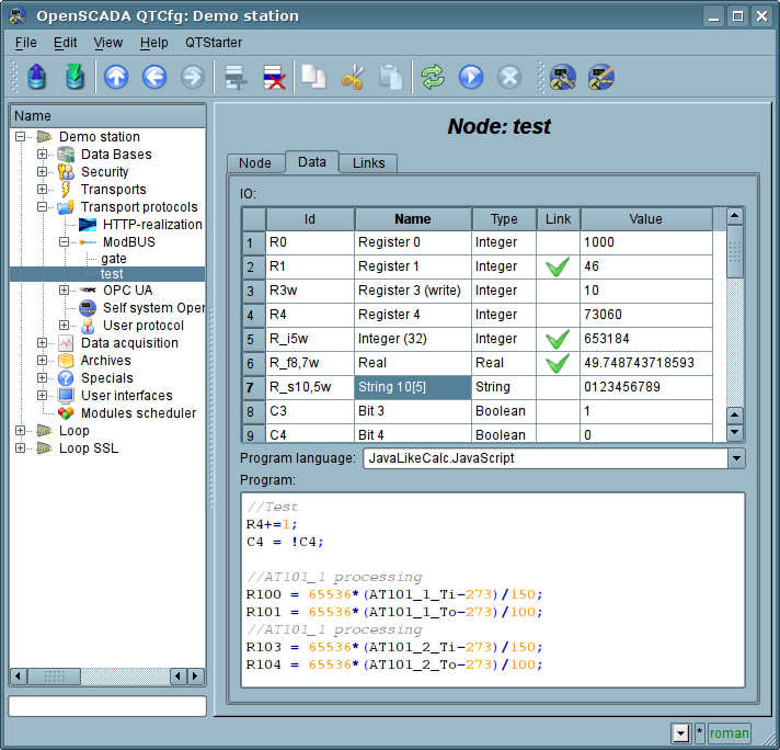

To form the table of the reflection of the data of ModBus network, namely, registers and bits the tab "Data" is provided(Fig.3). The tab "Data" contains a table of parameters and program for processing of the parameters with the specified programming language, which is available in the system OpenSCADA. Table contains the parameters with the properties:
All other parameters are internal and are used for a variety of intermediate calculations, processing, conversion and their values can be operative control and changed from the table into execution mode.
  • Name — The name of the parameter is used for the naming of the connection.
  • Type — Type of the parameter from the list: "Real", "Integer", "Boolean" and "String". For the registers and bits of ModBus it makes sense to set "Integer" and "Boolean" type, respectively. For the registers expanded by prefixes "f" and "s" need set types "Real" and "String", respectively.
  • Connection — Sign that this option should be to connect with the attribute of the parameter of subsystem "Data acquisition". These connections are set in the "Connection" tab.
  • Value — The original or current, if the node is switched on, the value of the parameter.
  • The table by default identifies several parameters of special appointment:
     (2 Kb) By into sets registers of expanded types can be used inaccessible symbol ',' then access to its from the procedure you can take only alternatively method, by object "arguments":
    arguments["R_s10,5w"] = "9876543210";
    The tab "Data" of the configuration page of the node of the protocol in the "Data" mode. (105 Êá)
    Fig.3. The tab "Data" of the configuration page of the node of the protocol in the "Data" mode.

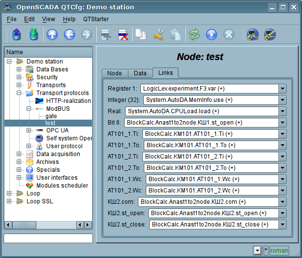

    For the parameter which are signed as links above it can be set the links only to switched off node of the protocol in the tab "Connections"(Figure 4).
    The tab "Links" of the configuration page of the node of the protocol in the "Data" mode. (95 Êá)
    Fig.4. The tab "Links" of the configuration page of the node of the protocol in the "Data" mode.

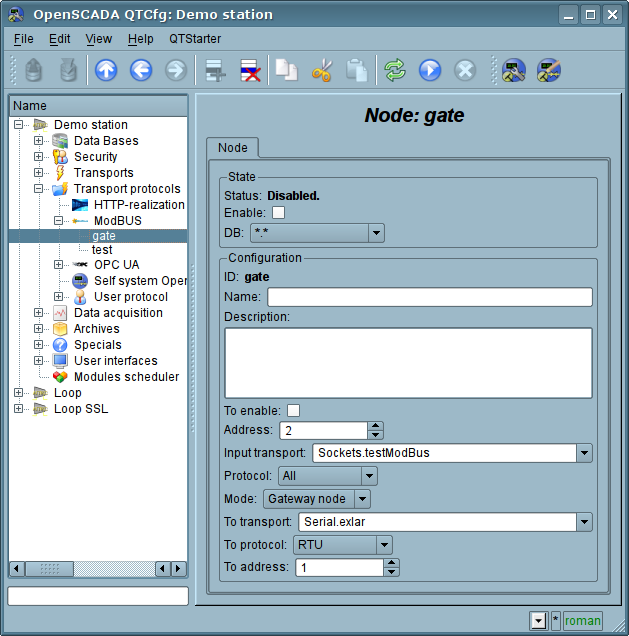

    The mode of the node of the protocol "Gateway of the node"
    Mode is used to carryover the requests to a separate device in the other ModBus network from the ModBus network, in which this node is configured. The overall configuration of the node is made in the tab "Node"(Fig. 5) by the parameters:
    The tab "Node" of the configuration page of the node of the protocol in the "Gateway of the node" mode. (74 Êá)
    Fig.5. The tab "Node" of the configuration page of the node of the protocol in the "Gateway of the node" mode.

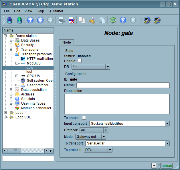

    The mode of the node of the protocol "Gateway of the network"
    Mode is used to carryover the requests of the network at whole to the other ModBus network from the ModBus network, in which this node is configured. Ie request to the device with any address will be sent to another network, without diverting. The overall configuration of the node is made in the tab "Node"(Fig. 6) by the parameters:
    The tab "Node" of the configuration page of the node of the protocol in the "Gateway of the network" mode. (71 Êá)
    Fig.6. The tab "Node" of the configuration page of the node of the protocol in the "Gateway of the network" mode.

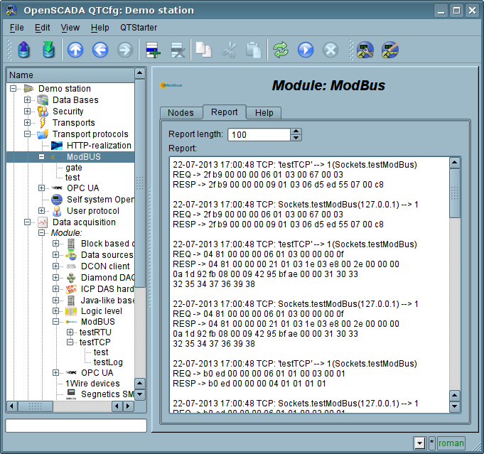

    2.3 Report of the ModBus requests
    To be able to monitor and to diagnosing the correct implementation of requests to the various components the a module provides an opportunity to incorporate the report of the requests that pass through the protocol module. The report included by indication of non zero number of entries in the tab "Report" of the page of the module of the protocol(Fig.7).
    "Report" tab of the page of the module of the protocol. (109 Êá)
    Fig.7. "Report" tab of the page of the module of the protocol.

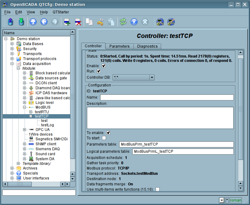

    For addition of a ModBus data source the controller is created and configured in the system OpenSCADA. Example of the configuration tab of the controller is depicted in Fig.8.
    Configuration tab of the controller. (119 Êá)
    Fig.8. Configuration tab of the controller.
    Using this tab you can set:

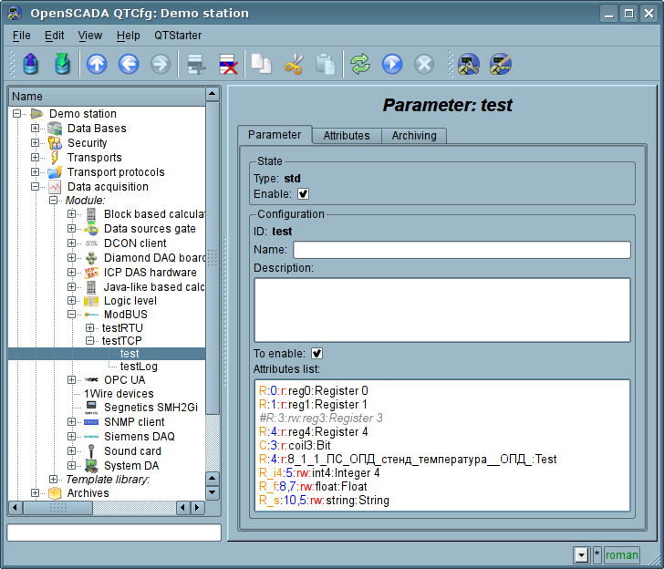

    Main page of configuration parameters of the standard type is shown in Figure 9.
    Configuration tab of the standard parameter type. (99 Êá)
    Fig.9. Configuration tab of the standard parameter type.
    The structure of the attribute in the parameter list of attributes can be written as follows: "{dt}:{numb}:{rw}:{id}:{name}".
    Where:
    dt — Modbus data type ("R"—register[3,6(16)], "C"—coil[1,5(15)], "RI" — input register[4], "CI"—input coil[2]);
    "R" and "RI" can be expanded by suffixes: "i2"—Int16, "i4"—Int32, "i8"—Int64, "u2"—UInt16, "u4"—UInt32, "f"—Float, "d"—Double, "b5"—Bit5, "s"—String (size by default is 10 and up to 100 registers);
    numb — ModBus device's data address (decimal, hexadecimal or octal) [0...65535];
    rw — read/write mode ("r"—read; "w"—write; "rw"—readwrite);
    id — created attribute identifier;
    name — created attribute name.
    Examples:
    "R:0x300:rw:var:Variable" — register access;
    "C:100:rw:var1:Variable 1" — coin access;
    "R_f:200:r:float:Float" — get float from registers 200 and 201;
    "R_i4:400,300:r:int32:Int32" — get int32 from registers 400 and 300;
    "R_b10:25:r:rBit:Reg bit" — get bit 10 from register 25;
    "R_s:15,20:r:str:Reg blk" — get string, registers block, from register 15 and size 20."
    Line which start at symbol '#' is commentary and processing for it pass.

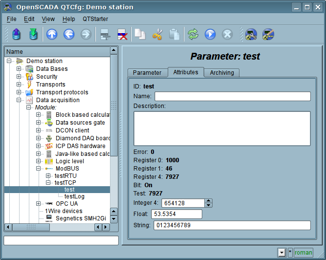

    In accordance with a specified list of attributes interrogation and the creation of the attributes of the parameter is carried out(Figure 10).
    Tab of the attributes of the standard parameter type. (76 Êá)
    Fig.10. Tab of the attributes of the standard parameter type.

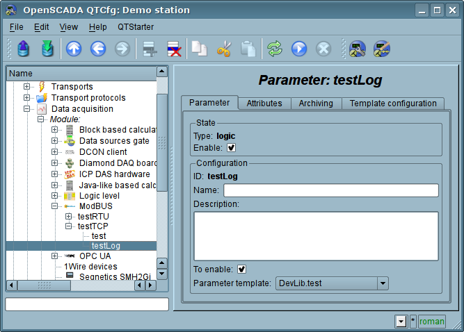

    Logical parameter type(logic)
    Main page of configuration parameters of the logical type is shown in Figure 11.
    Configuration tab of the logical parameter type. (68 Êá)
    Ðèñ.11. Configuration tab of the logical parameter type.
    When forming a template for the logical type of the parameter of the controller, do not take into account the reference format template, since it is not used and can be omitted. Same reference value, when configuring the the template (Fig. 12), written in the format: "{dt}:{numb}:{rw}".

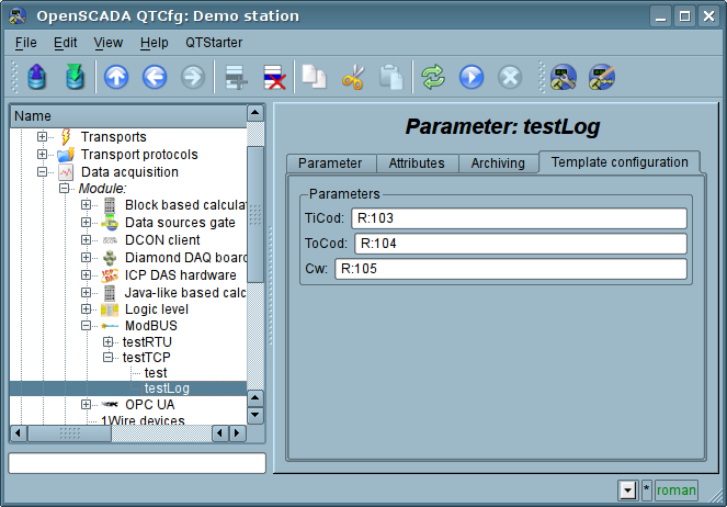

    Tab "Template configuration" of the logical parameter type. (62 Êá)
    Ðèñ.12. Tab "Template configuration" of the logical parameter type.

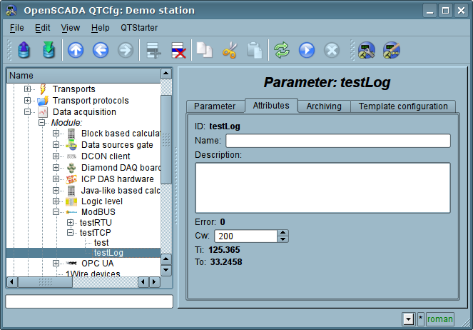

    The module provides a special treatment of a number of attributes of the template:
    In accordance with the pattern underlying parameter, we get a set of attributes of the parameter Fig.13.
    Tab of the attributes of the logical parameter type. (63 Êá)
    Fig.13. Tab of the attributes of the logical parameter type.
