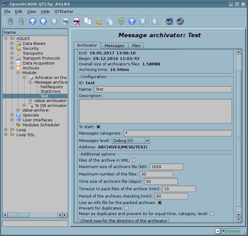

Module provides additional settings for the archiving process (Fig. 1).
Additional settings of an archiving process of messages. (119 Êá)
Fig.1. Additional settings of an archiving process of messages.
Those parameters include:

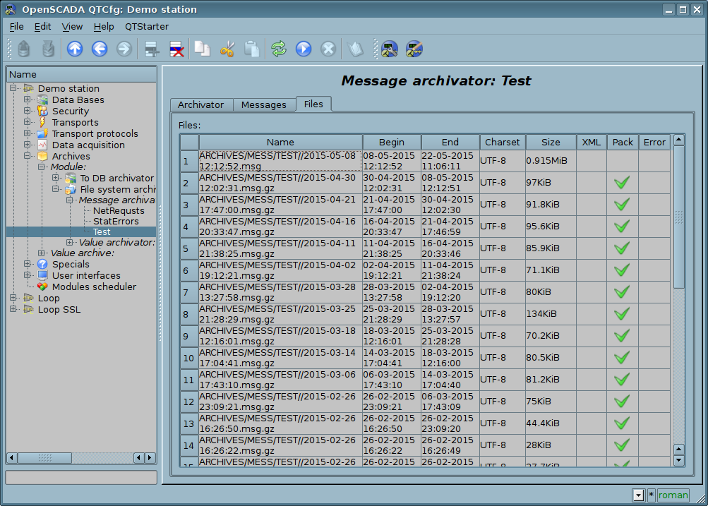

For the archivator's files control you can see to tab "Files" (Fig. 2).
Tab "Files" of the messages archive object. (169 Êá)
Fig.2. Tab "Files" of the messages archivator object.

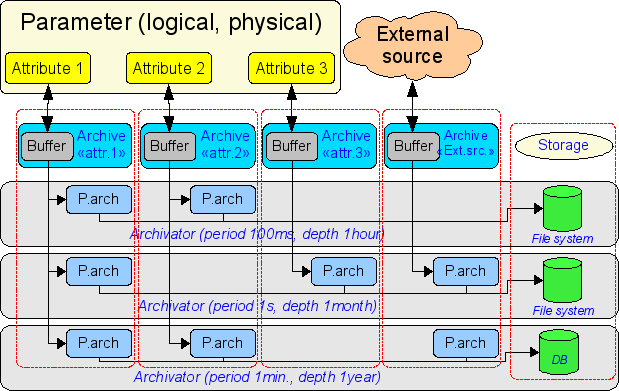

    Archives of values are formed particularly by archivers of the values for each registered archive. There can be a lot of archivers with individual settings that allow to divide the archives by various parameters, such as the accuracy and depth.
    Archive of values is an independent component, which includes buffer processed by archivers. The main parameter of archive of value is a source of data. As a source of data may make the attributes of the parameters of subsystem "Data acquisition", as well as other external data sources (passive mode). Other sources of data could be: network archivers of remote OpenSCADA systems, environment of programming of systems OpenSCADA etc. No less important parameters are the parameters of the archive buffer. From the parameters of the buffer the opportunity of working of archivers depends on. Thus, the frequency of values in the buffer should be no more than the frequency of the fastest archiver, a buffer size not less than double the amount for the slowest archiver. Otherwise, the possible loss of data!
    The overall scheme of archival of values vividly depicted in Fig. 3.
    The overall scheme of process of archival values of module FSArch. (35 Êá)
    Fig.3. The overall scheme of process of archival values of module FSArch.

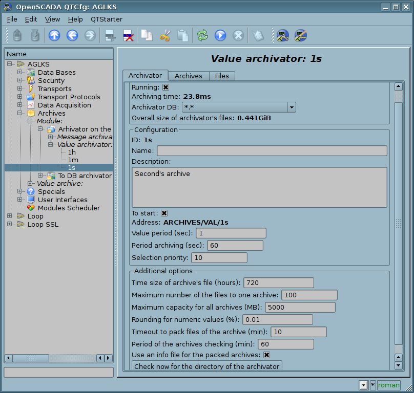

    The module provides additional settings for the archiving process (Fig. 4).
    Additional settings of an archiving process of values. (115 Êá)
    Fig.4. Additional settings of an archiving process of values.

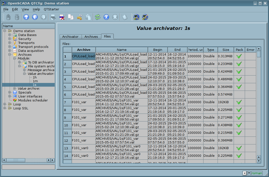

    For the archivator's files control you can see to tab "Files" (Fig. 5).
    Tab "Files" of the values archivator object. (180 Êá)
    Fig.5. Tab "Files" of the values archivator object.

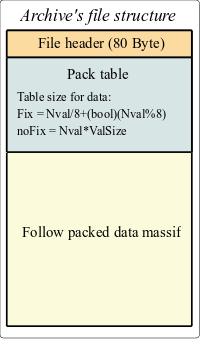

    To implement the archiving to the file system the following requirements are to be done:
    In accordance with the above requirements archiving is organized by method of plurality of files (for each source). Cyclical of archive sold at the file level, ie a new file is created, and the oldest one is removed. For fast compression the method of tightening to the last equal value is used. For this purpose, the bit archiving table is provided with the size of one to one with the number of stored data. Ie each bit corresponds to the single value in the archive. The presence of bit indicates the presence of value. For the thread of the same values bits reduced to zero. In the case of the string archive the table is not a bit but the byte one and contains the length of the appropriate value. In the case of reception of the thread of equal values, the length will be zero and the first same value will be read. As the table is bite one, the archive will be able to keep strings with the length more than 255 characters. Thus, the methods of storage can be divided into a method of fixed and not fixed data size. The overall structure of the archive is shown in Fig. 6.
    The overall structure of the value archive. (13 Êá)
    Fig.6. The overall structure of the value archive.
    When you create a new archive file there is formed: the title ( the structure of the title is in the table 1), zero bit table of package of the archive and the first false value. Thus, the archive will be initialized with false values. In the future, the new values will be inserted in the area of values with adjustment of index table of packaging. It follows that the passive archives will dwindle in the files with the size of the title and the bit table.
    Table 1. The structure of the header of archive file
    FieldDescriptionSize in bite(bit)
    f_tpSystem name of the archive ("OpenSCADA Val Arch.")20
    archiveName of the archive to which the file belongs.20
    begStart time of the archive data (microseconds)8
    endEnd time of the archive data (microseconds)8
    periodPeriodicity of the archive (microseconds)8

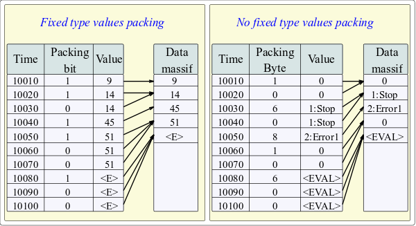

    vtpType of value in the archive (Boolean, Integer, Real, String)(3)
    hgridÑriterion of using of hard grid in the buffer of the archive(1)
    hresÑriterion of using of time of high resolution (mcs) in the buffer of the archive(1)
    reserveReserve14
    termThe symbol of the end of the header of file (0x55)1
    Explaining of the mechanism of consistent packaging is given in Fig. 7. As can be seen from the figure a sign of the package contains a length (not fixed types) or a sign of the package (fixed types) of the separately taken value. This means that to obtain the desired value of displacement it is necessary to sum up the length of previous valid values. The implementation of this operation each time and for each value is highly invoice operation. Therefore, the mechanism of caching of displacement of the values is provided. The mechanism caches displacement of values through predefined their quantity, as well as cashes the last value for which the access is made (separately for reading and writing).
    The mechanism of follow packaging of values. (38 Êá)
    Fig. 7. The mechanism of follow packaging of values.
    Changes of the values in the existing archive is also provided. However, given the necessity to implement the shifting of the tail of the archive, it is recommended to perform this operation as sparingly as possible and with as far as possible large blocks.
