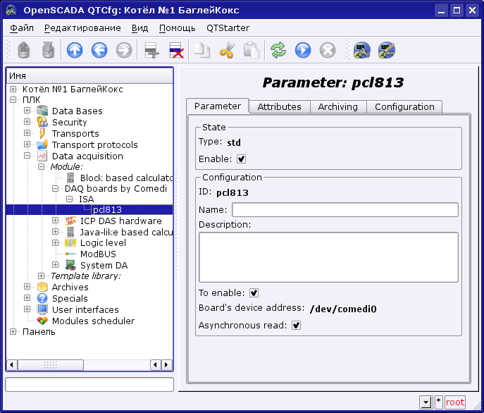

The parameter object is a direct representative-reflection for DAQ-board, which contained attributes set with types and it quantity depending from specific board. Parameter's object configuration tab is shown in Figure 2.
Parameter's object configuration tab — DAQ board. (75 Êá)
Fig.2. Parameter's object configuration tab — DAQ board.

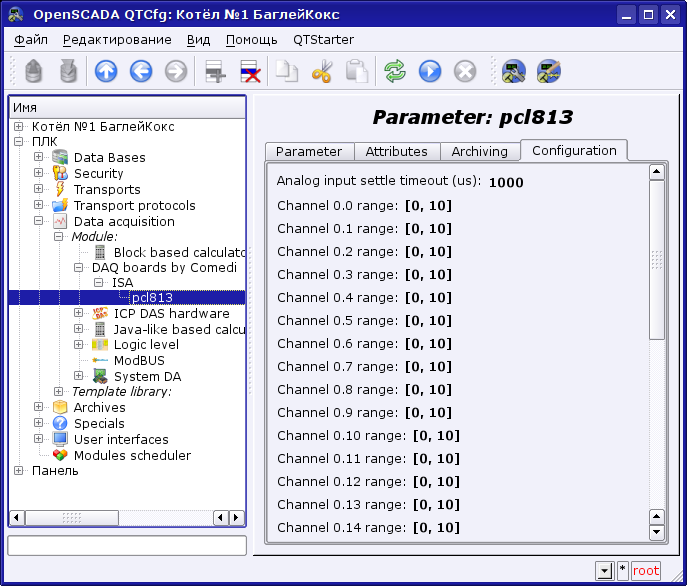

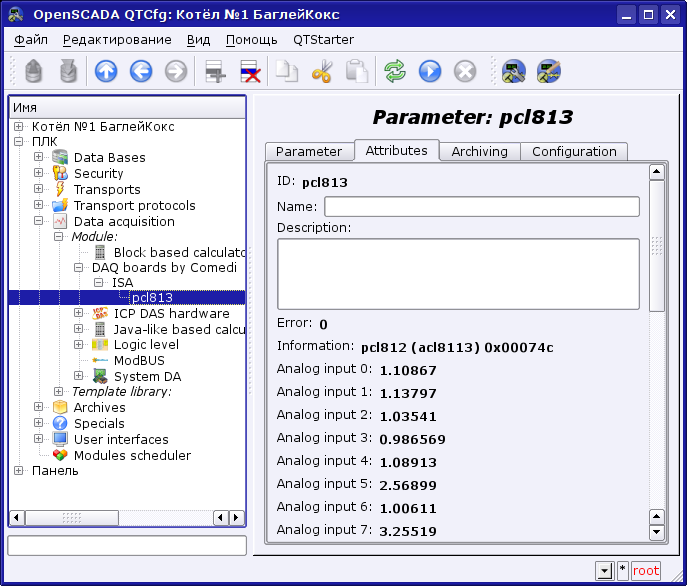

Tab "Attributes" for board ACL-8113 is shown in Figure 3. For some types of data can be accessed "Configuration" tab. For example, this tab (Fig.4) for boards with analog inputs has the values set timeout and ranges selection for each channel.
Tab "Attributes" of parameter object of board ACL-8113. (85 Êá)
Fig.3. Tab "Attributes" of parameter object of board ACL-8113.
Tab "Configuration" of parameter object of board ACL-8113. (88 Êá)
Fig.4. Tab "Configuration" of parameter object of board ACL-8113.
