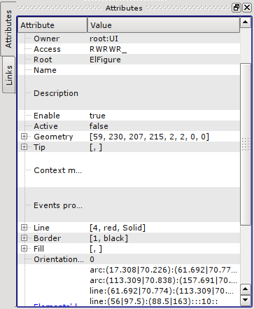

Lets suppose that we need to add a graphic element to the one of the existing libraries. To do this, select the name of the library, and click the (Ñîçäàíèå íîâîãî âèäæåòà ýëåìåíòàðíîé ôèãóðû (2 Kb)) on the toolbar. In the appeared window enter the ID and name of the new graphic element. After that lets select the created item and click (Ïåðåõîä ê ðåäàêòèðîâàíèþ âèäæåòà (2 Kb)) button. The drawing area will appear on the right. By double-clicking on that field or either using the context menu lets enter the editing mode — the mode of the graphical editor that allows you to perform all provided manipulations with the figures. At a time when we have the created graphic element in focus, the "Attributes" tab takes the form, shown in Fig. 5.3.a.
Attributes of elementary figure. (24 Êá)
Fig. 5.3.a. Attributes of elementary figure.
With the help of mouse or the "Geometry " field of the "Attributes" tab lets define the drawing area size and scale coefficients.
Using the "Line" field of the "Attributes" tab, lets define the width, color, lines' style of the figures which we'll draw. With the "Border" field lets define the width and color of the border. The "Fill" field allows you to specify color, and image for the fills. "Elements' list" contains a list of primitives used to create the graphic object. Elements of all fields of the "Attributes" tab can be dynamically changed in the scripts (programs) of the user.

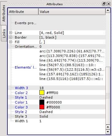

Then the "Attributes" tab will be appended by the fields: Point 1 (1), Point 2 (2), Width 1(w1), Width 2(w2), Color 1(c1), Color 2(c2), Style 1 (s1) (Fig. 5.3.b), values of these fields can be changed programmatically, by using a programming language of the OpenSCADA project. It is obvious that if desired not all properties of the primitive can be declared dynamic, but one or several, besides one dynamic property can be used repeatedly.
Editing the coordinates of control points is made either with the mouse or through changes in the "Elements' list " for static points, or directly in the "Attributes" tab, having the dynamic ones ("Point 1"...). Editing the other properties is made by means of changing the contents of the fields "Line", "Border", "Fill" of the "Attributes" tab or the "Elements' list".
Dynamic attributes of elementary figure. (26 Êá)
Fig. 5.3.b. Dynamic attributes of elementary figure.

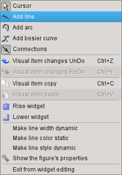

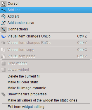

5.4. Popup menu of the graphic editor
The popup menu by the right-clicking in the editable widget is provided. Depending on what an object is under the mouse popup menu can take several different forms. Below, in Figure 5.4, there are examples of the popup menu.
The popup menu for the lines (line, arc, B`zier curve). (23 Êá) The popup menu for the fill (24 Êá)
Fig. 5.4. The popup menu for the lines (line, arc, Bézier curve) and for the fill from left to right.
The popup menu includes the following sections (from top to bottom):

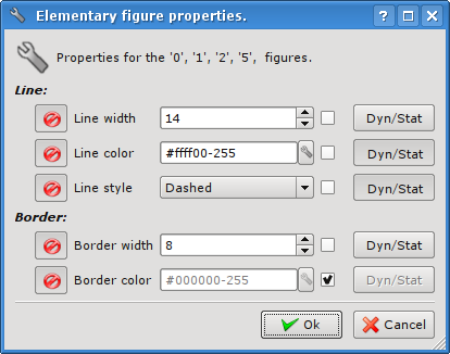

5.5. Properties dialog of the elementary figure
Dialog, versions of which are shown in Figures 5.5.a, 5.5.b, 5.5.c, is implemented for interactive and comfortable user control of the properties of the figure(s).
Elementary figure's properties dialog for single figure (line, arc or a Bézier curve). (40 Êá)
Fig. 5.5.a. Elementary figure's properties dialog for single figure (line, arc or a Bézier curve).
Elementary figure's properties dialog for the group of selected figures. (33 Êá) Elementary figure's properties dialog for the group of selected figures with disabled properties. (30 Êá)
Fig. 5.5.b. Elementary figure's properties dialog for the group of selected figures.

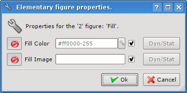

Elementary figure's properties dialog for the fill. (19 Êá)
Fig. 5.5.c. Elementary figure's properties dialog for the fill.

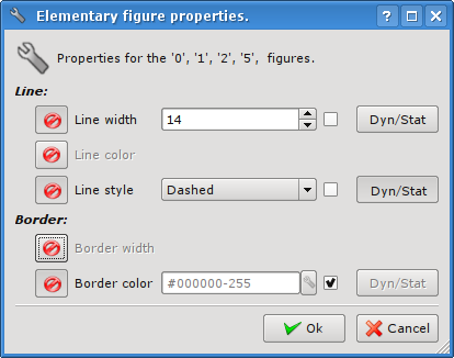

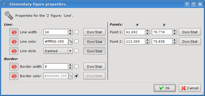

As can be seen from the figures above, the dialog can be of three different forms, depending on the object for which it is called. In the title of the dialog there are the numbers of figures, for which it is called. These numbers correspond to the positions of figures in the "Elements' list", starting from the top.
If the dialog called for a single figure (line, arc or a Bézier curve), then it is possible to edit the points' coordinates of the figure (Fig. 5.5.a). If the point is connected to the point of another figure or figures, and "bindings" ("Connections") are enabled, then entered coordinates will be applied to all connected figures and fills, which involved the figure, will be redrawn accordingly.
If the dialog is called for the group of selected figures (Fig. 5.5.b), properties (attributes) listed in the dialog will be applied to all figures listed in the title of the dialog. When you call the dialog in the fields of the properties will be shown the data of the figure from the group of selected ones, for which it was called the popup menu. There is the possibility to include/exclude certain properties of the dialog. For this the (Êíîïêà âêëþ÷åíèÿ/èñêëþ÷åíèÿ ñâîéñòâ (2 Kb)) button is provided. In the case of exclusion of individual properties, they will not be processed upon acceptation of the dialog ("Ok" button). After the acceptation of the dialog, all of the data of the included properties will be applied to the whole group of figures.
Dialog for the fill's properties (Fig. 5.5.c) allows you to manage the properties of the specific fill.
When selecting a check box to the right of a property, it (the property) after the acceptation of the dialog is set to the default value, which is listed in the "Attributes" tab. The "Dyn/Stat" buttons make the appropriate properties dynamic or static.
