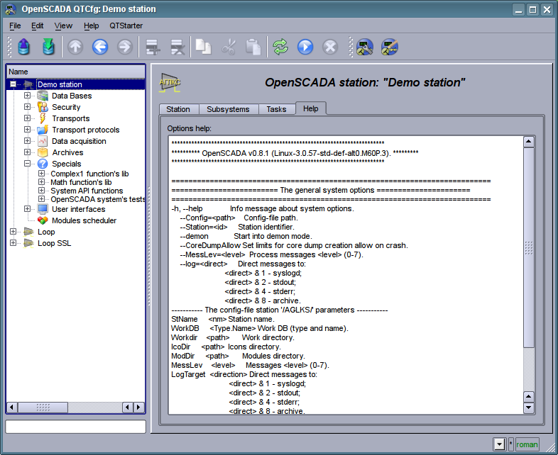

4.10. Configuration file of the OpenSCADA and parameters of command-line OpenSCADA execution.
Configuration file of the OpenSCADA system is provided to store the system and general configuration of OpenSCADA-station. Only in the configuration file and through the command-line options you can specify the part of the key system parameters of the station, so familiarity with the structure of the configuration file is necessary for professionals who make solutions based on OpenSCADA.
The configuration file of the OpenSCADA system can be called somehow, but the oscada.xml name and derived from it are accepted. The configuration file is usually indicated when you start the station by the command-line option "--config=/home/roman/roman/work/OScadaD/etc/oscada_demo.xml". For the convenience of the calling the startup scripts of the station are created with the correct configuration file or used the project manager at start script openscada_start. For example script (openscada_demo) uses for the demo station execution:
#!/bin/sh
openscada --config=/etc/oscada_demo.xml $@
If the configuration file is not specified then the standard configuration file: /etc/oscada.xml is used.
Structure of the configuration file based on the extensible markup language XML. Therefore the strict adherence to the rules of XML syntax is required. An example of the configuration file of the OpenSCADA, with configuration nodes of most of the OpenASCADA components, is given below:

The result of the command: # ./openscada_AGLKS --help
Files[Hide files/form]
2013-01-28 21:17:59    (85 Kb)  cfg_help_en.png The "Help" tab of the OpenSCADA component.
