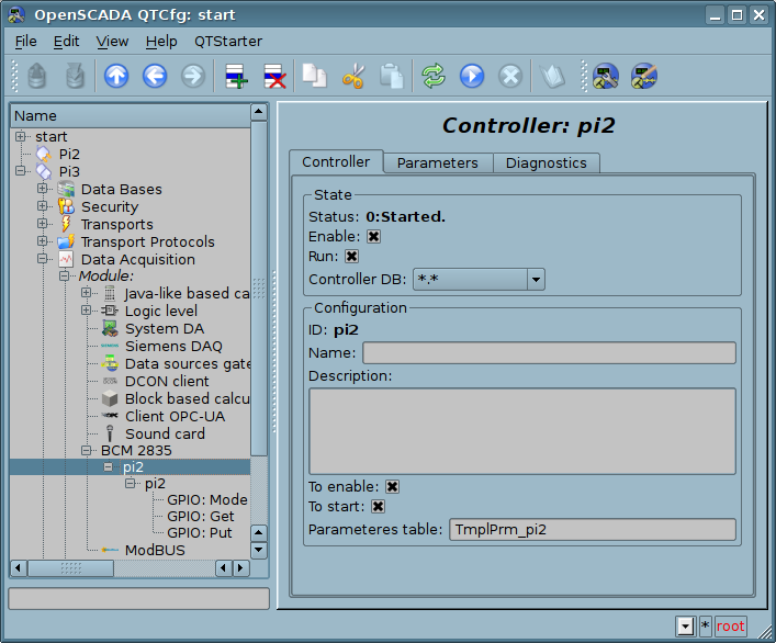

1. Controller object
GPIO into OpenSCADA configured with new controller object creation (Fig.1) and the container parameters' objects — a single parameter of the board's GPIO.
Configuration tab of the controller object. (83 Êá)
Fig.1. Configuration tab of the controller object.

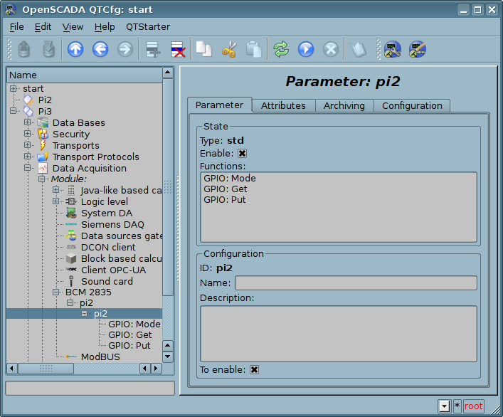

2. The controller's parameter object
The parameter object is a direct representative-reflection for the GPIO, which contains attributes set with Boolean types and it whole quantity 32. Parameter's object configuration tab is shown in Figure 2. The acquisition data is done only in synchronous mode but GPIO must be fast.
Parameter's object configuration tab. (80 Êá)
Fig.2. Parameter's object configuration tab.

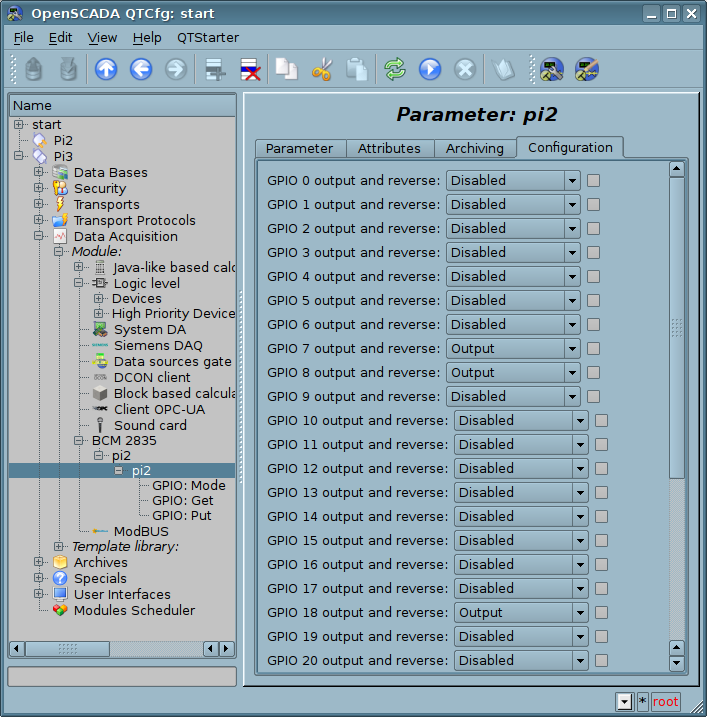

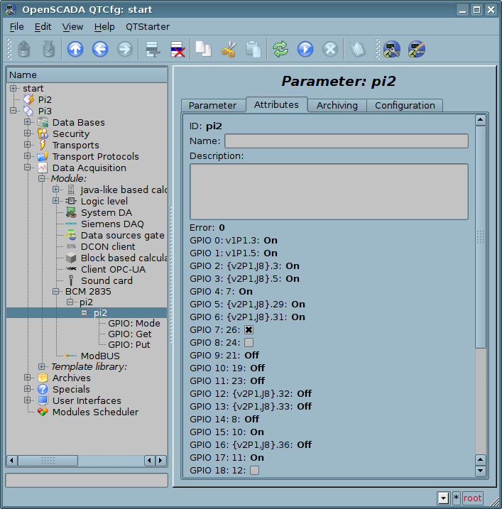

Tab "Attributes" for the GPIO is shown in Figure 3. For the GPIO there is accessed also "Configuration" tab (Fig.4) with IO mode and reverse state.
Tab "Attributes" of the parameter object. (115 Êá)
Fig.3. Tab "Attributes" of the parameter object.
Tab "Configuration" of the parameter object. (156 Êá)
Fig.4. Tab "Configuration" of the parameter object.
