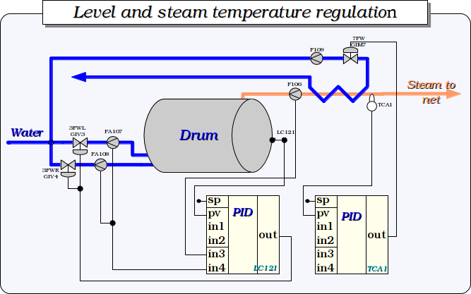

Before the creation the model of the boiler the schematic diagram of the technological process model was formed, based on the schematic diagram of the real process. The scheme is shown in Fig. 1.
The boiler DMK #9 technological scheme. (141 Êá)
Fig. 1. The boiler DMK #9 technological scheme.

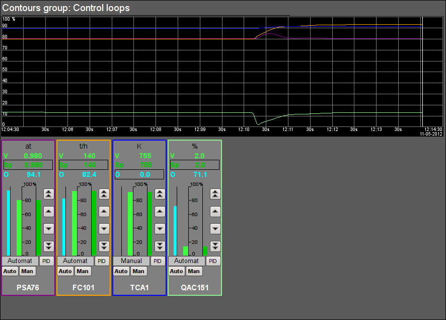

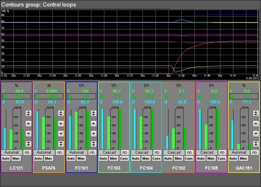

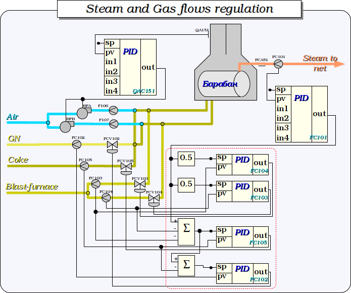

PID regulator (pid) kotel9_cntr.TCA1, kotel9_cntr.F_air_gas, kotel9_cntr.QAC151, kotel9_cntr.LC121, kotel9_cntr.PCA51, kotel9_cntr.FC101, kotel9_cntr.FC102, kotel9_cntr.FC103, kotel9_cntr.FC104, kotel9_cntr.FC105, kotel9_cntr.PSA76
Library "Boiler Ê9" (DAQ.JavaLikeCalc.k9)
Divider (Delitel) kotel9_cntr.Air_Gas
Total fuel flow in boiler (Fsum) kotel9_cntr.Fsum
Inversion (Inversion) kotel9_cntr.5VP_inv

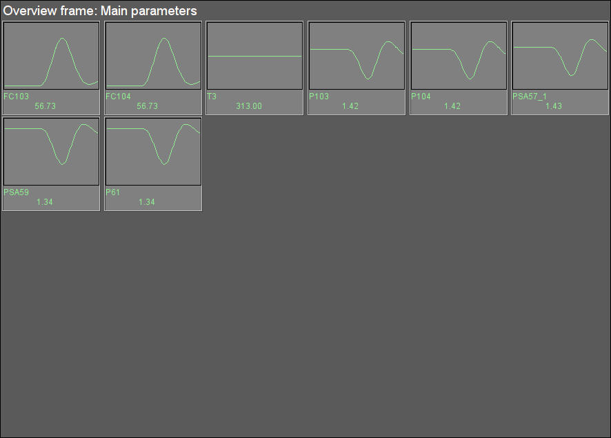

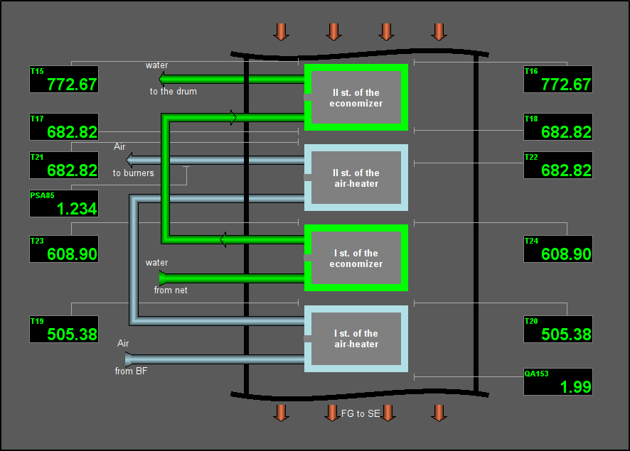

Through the usage of the apparatus models' library and the dynamic models building conception it was obtained the dynamic model, from which you can get the parameters at any point of the schematic diagram both for the study and for testing the control algorithms.
For information about the technological process the TP parameters were created (Table 3), which provide data from selected nodes of the model.

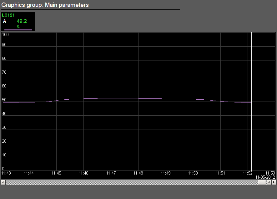

DMC Boiler9 (BlockCalc.kotel9)

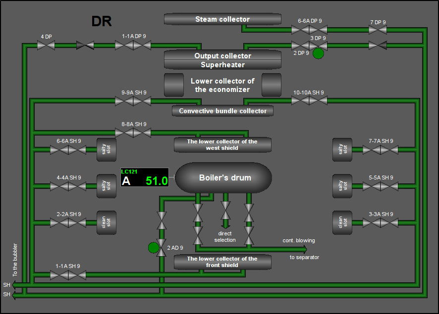

LC121 The water level in the boiler's drum Áàðàáàí.Lo

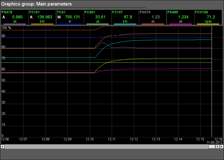

PCVG76 SEA productivity rpm, (0;100), Precision 1 ÄÑÀ.N
PCVG77 SEB productivity rpm, (0;100), Precision 1 ÄÑÁ.N
FCV106 BFA productivity rpm, (0;100), Precision 1 ÄÂÀ.N
FCV107 BFB productivity rpm, (0;100), Precision 1 ÄÂÁ.N
PCA51 Steam pressure after the MSV at, (0;50), Precision 2 4ÃÏÇ9.Po

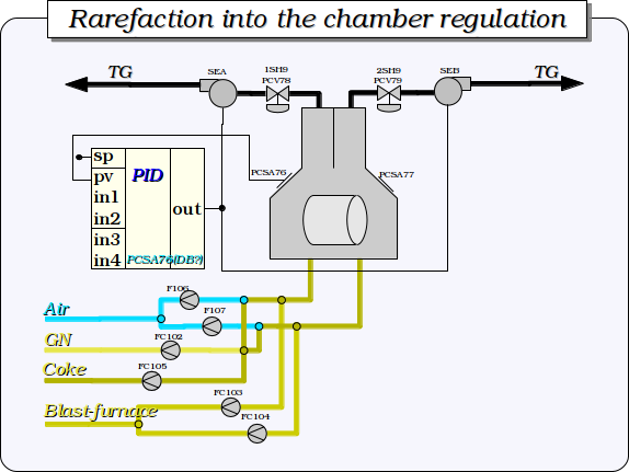

Rarefaction into the chamber regulation. (48 Êá)
Fig. 3. Rarefaction in the furnance regulation.
Steam and Gas flows regulation. (86 Êá)
Fig. 4. Steam and Gas flows regulation.

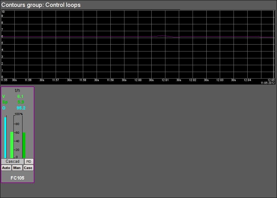

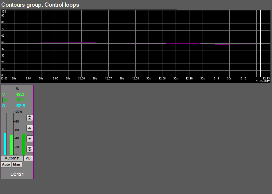

3 User interface
The model's user interface contains eleven signal objects (Fig. 5). Each object contains several mnemo, graphics group, contour group and overviews group.
User's interface generic view window. (133 Êá)
Fig. 5. General view of the user interface window.

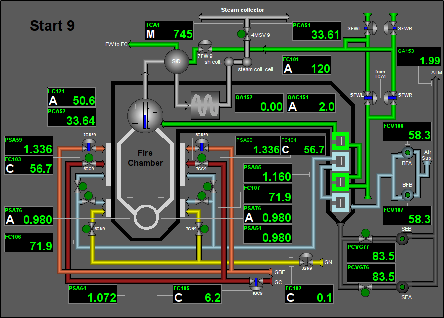

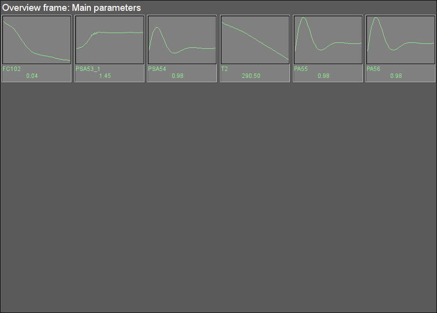

3.1 Signal object "Start"
Signal object "Start" mnemo. (90 Êá)
Fig. 6. Signal object "Start" mnemo.

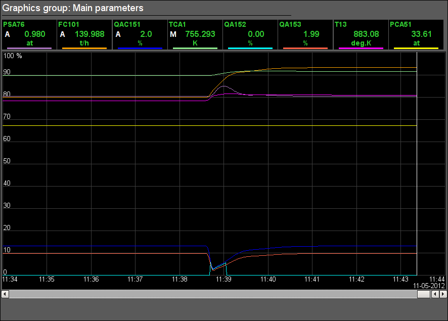

Signal object "Start" graphics group. (25 Êá)
Fig. 7. Signal object "Start" graphics group.

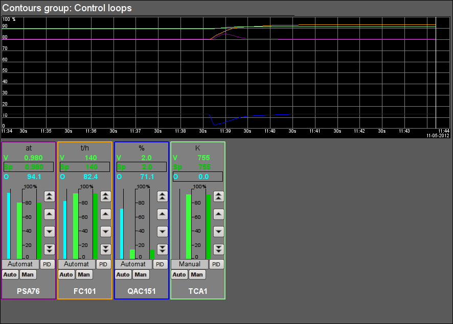

Signal object "Start" contours group. (38 Êá)
Fig. 8. Signal object "Start" contours group.

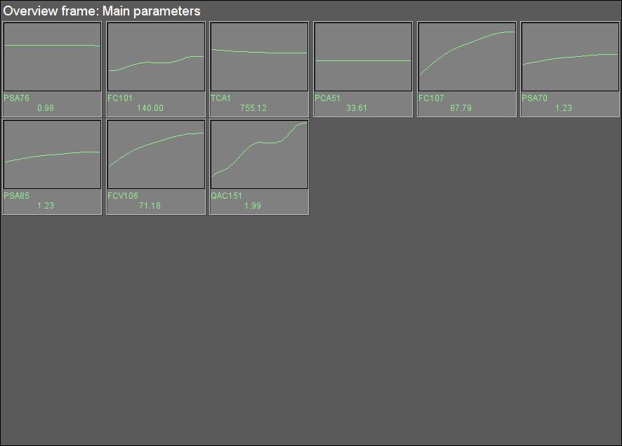

Signal object "Start" overview group. (15 Êá)
Fig. 9. Signal object "Start" overview group.

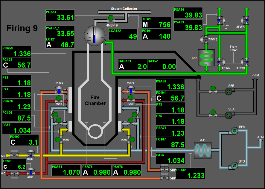

3.2 Signal object "Firing"
Signal object "Firing" mnemo. (88 Êá)
Fig. 10. Signal object "Firing" mnemo.

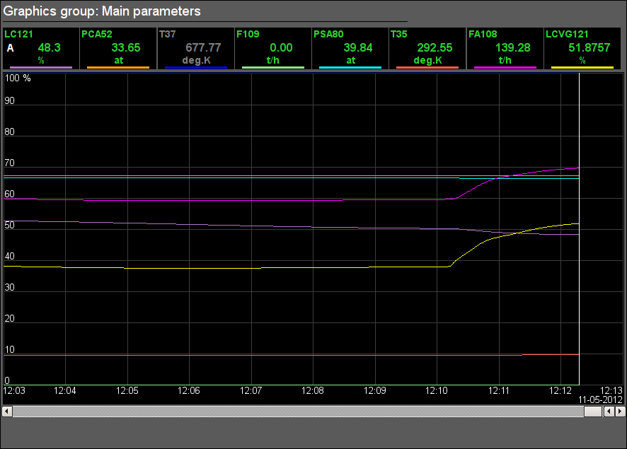

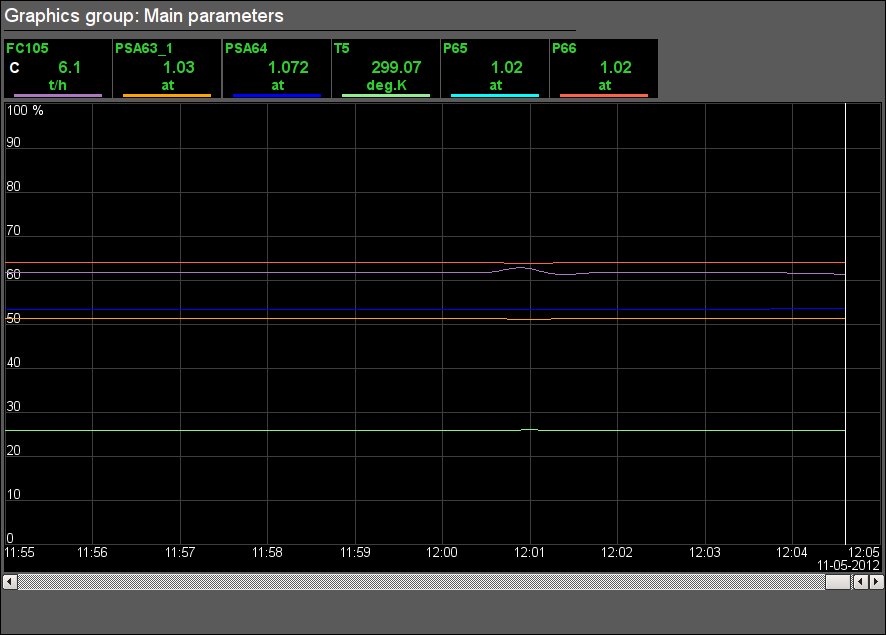

Signal object "Firing" graphics group. (26 Êá)
Fig. 11. Signal object "Firing" graphics group.

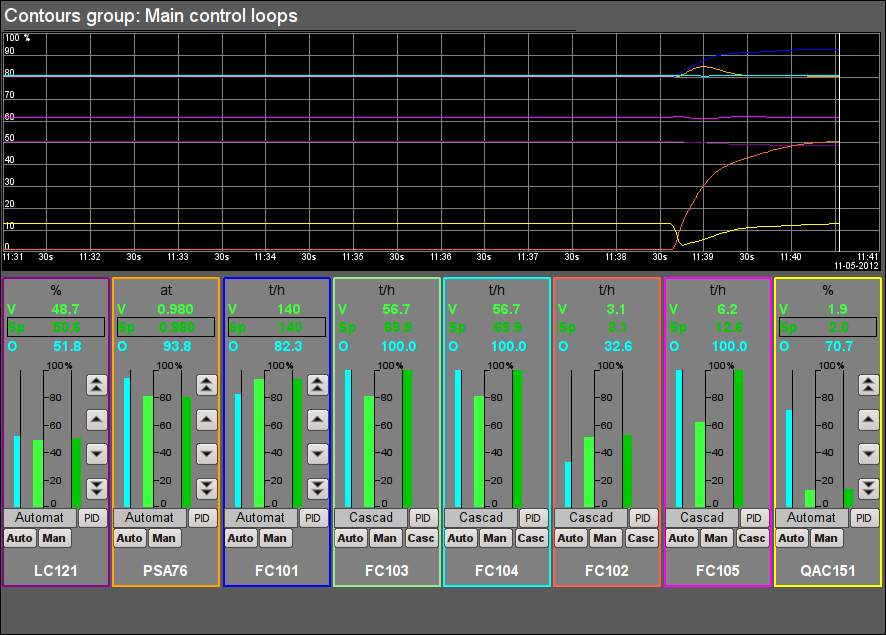

Signal object "Firing" contour group. (37 Êá)
Fig. 12. Signal object "Firing" contour group.

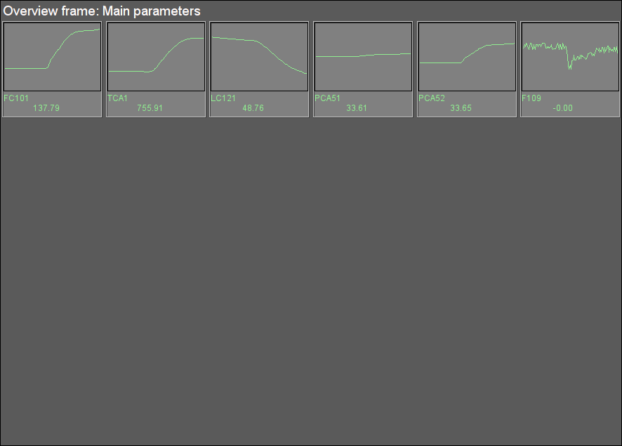

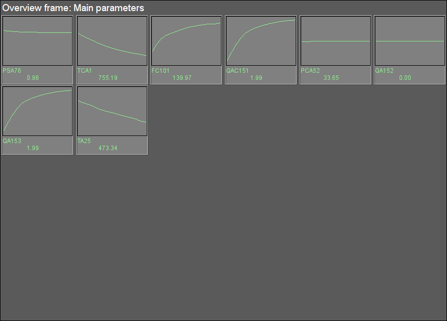

Signal object "Firing" overview group. (15 Êá)
Fig. 13. Signal object "Firing" overview group.

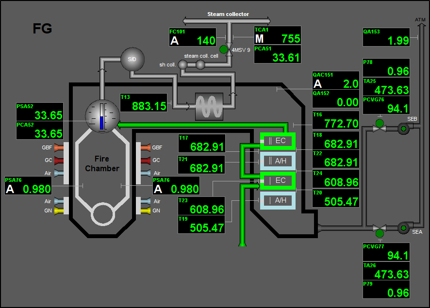

3.3 Signal object "Flue Gases"
Signal object "Flue Gases" mnemo. (63 Êá)
Fig. 14. Signal object "Flue Gases" mnemo.

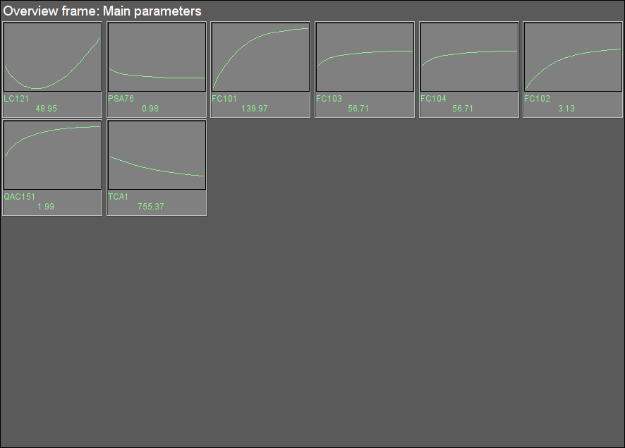

Signal object "Flue Gases" overview group. (19 Êá)
Fig. 18. Signal object "Flue Gases" overview group.

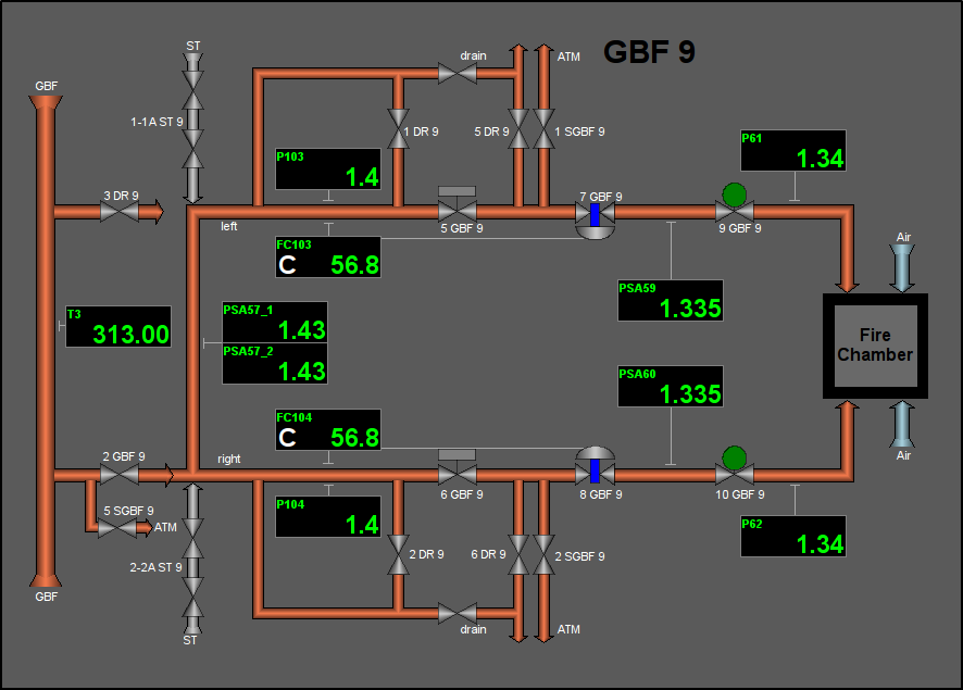

3.5 Signal object "GBF"
Signal object "GBF" mnemo. (57 Êá)
Fig. 23. Signal object "GBF" mnemo.

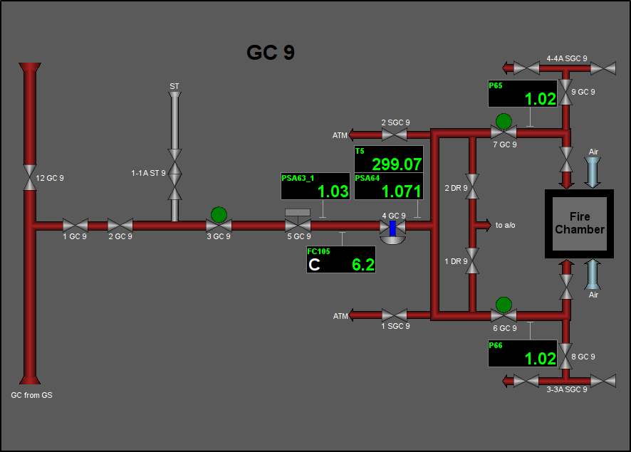

3.7 Signal object "GC"
Signal object "GC" mnemo. (53 Êá)
Fig. 31. Signal object "GC" mnemo.

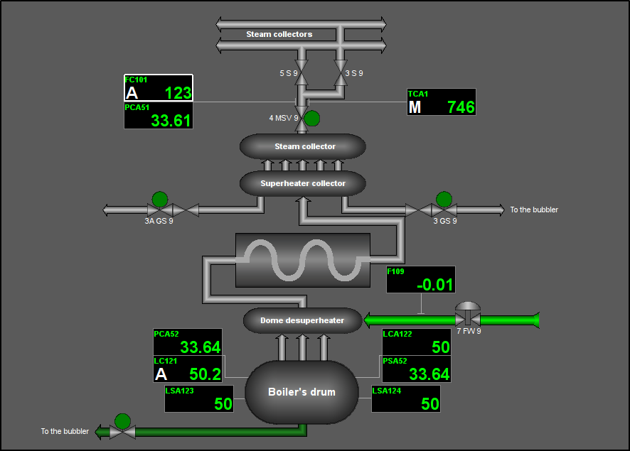

3.8 Signal object "STEAM"
Signal object "STEAM" mnemo. (50 Êá)
Fig. 35. Signal object "STEAM" mnemo.

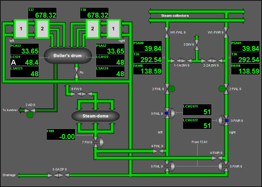

3.9 Signal object "FW"
Signal object "FW" mnemo. (67 Êá)
Fig. 39. Signal object "FW" mnemo.

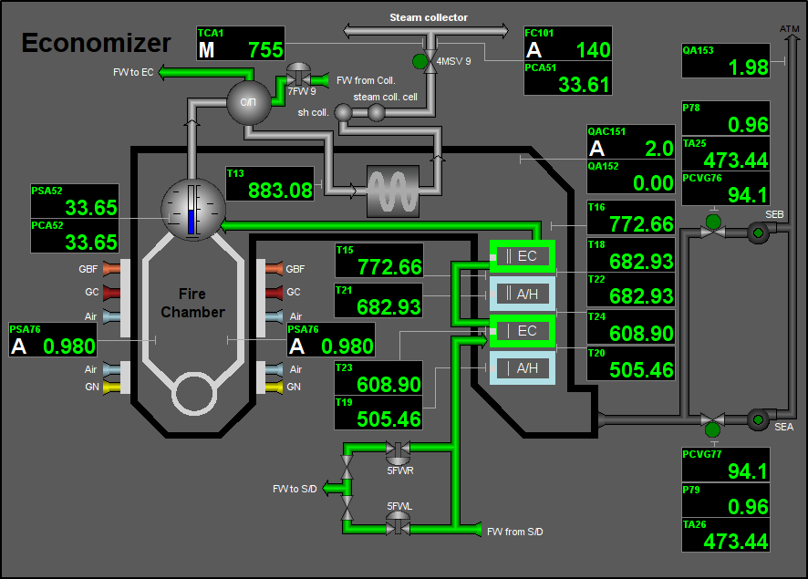

3.10 Signal object "Economizer"
Signal object "Economizer" mnemo. (75 Êá)
Fig. 43. Signal object "Economizer" mnemo.

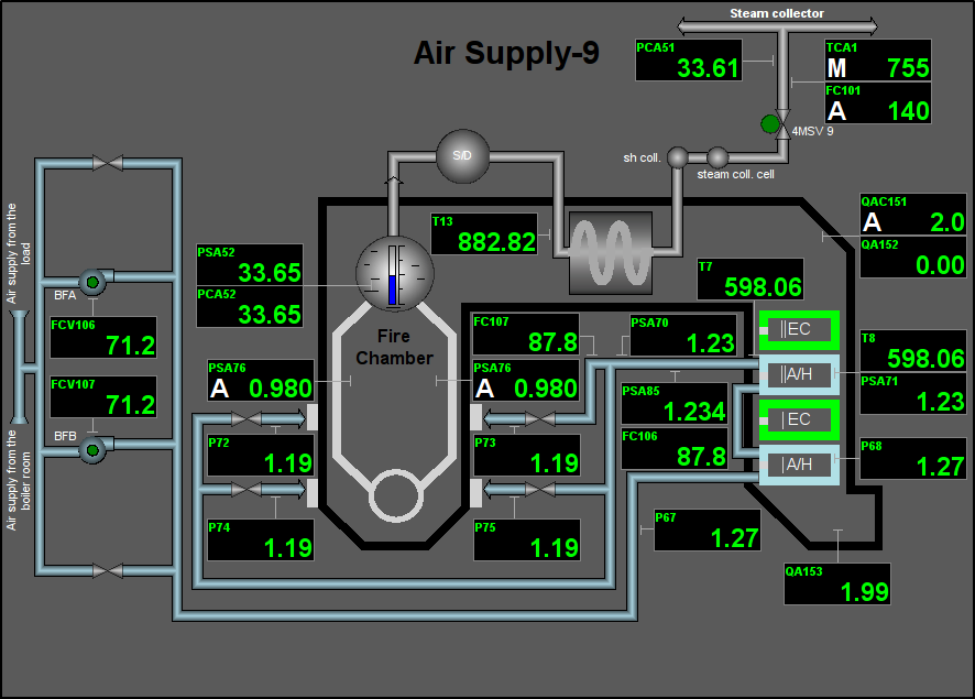

3.11 Signal object "AirSup"
Signal object "AirSup" mnemo. (65 Êá)
Fig. 47. Signal object "AirSup" mnemo.
Signal object "AirSup" mnemo 2. (53 Êá)
Fig. 48. Signal object "AirSup" mnemo 2.
