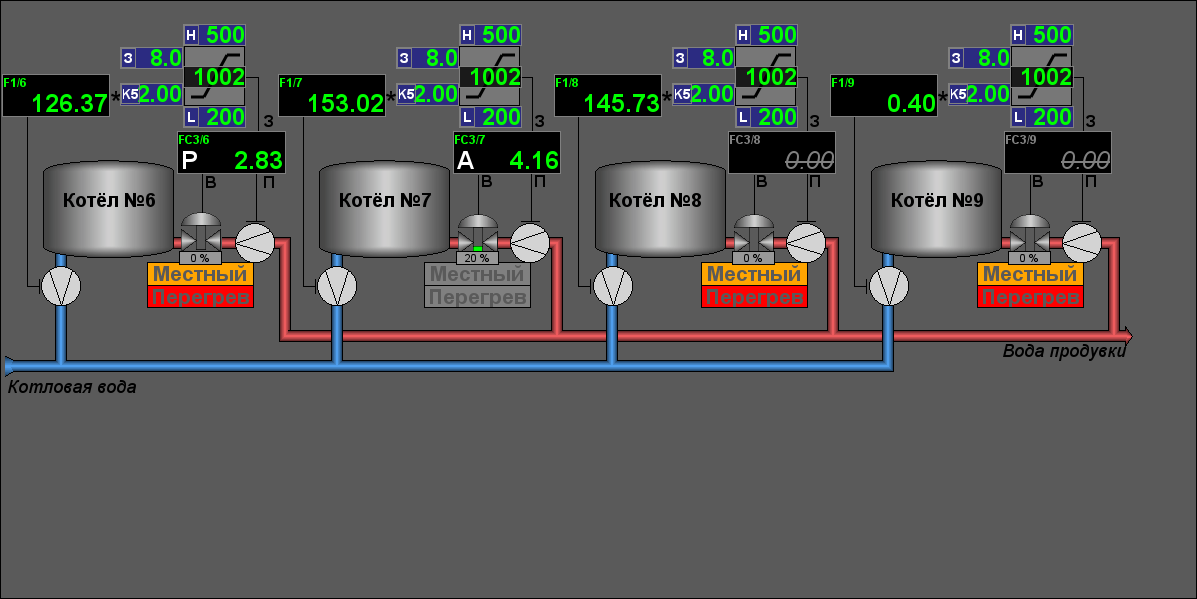

ACS "Continuous blowing", implemented into the generic-station controller, represented by valves of flow rate of continuous blowing with a pulse control. ACS signals entered direct to the PLC modules. Due to need of controlling the ACS by operator of the boilers it's interface entered to ACS BDM, and the Generic-station PLC enabled to network of ACS "BDM".

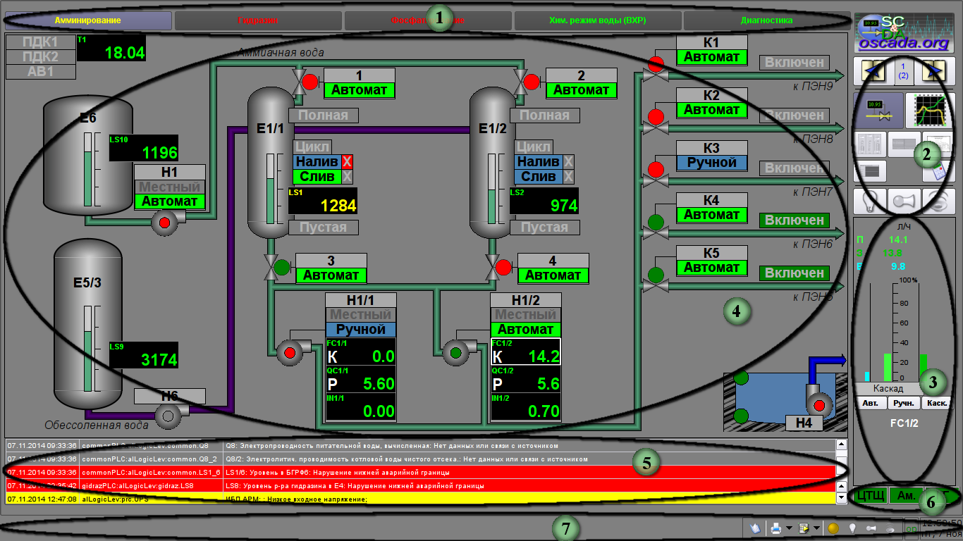

Information about the technological process represents on video-cadres forming by the program of displaying on a display's screen as part of AWP. The displaying information has a defined output area into the video-cadre and depends from it's destination. On figure 5 by digits is pointed the output areas of the video-cadre:
1. panel of signal objects;
2. panel of selection of displaying type, navigation by the video-cadres and local quittance;
3. panel of control;
4. workplace of the displaying;
5. active violation tables;
6. states of connections to PLC;
7. panel of states with instruments.
Fig. 5. Video-cadre structure.

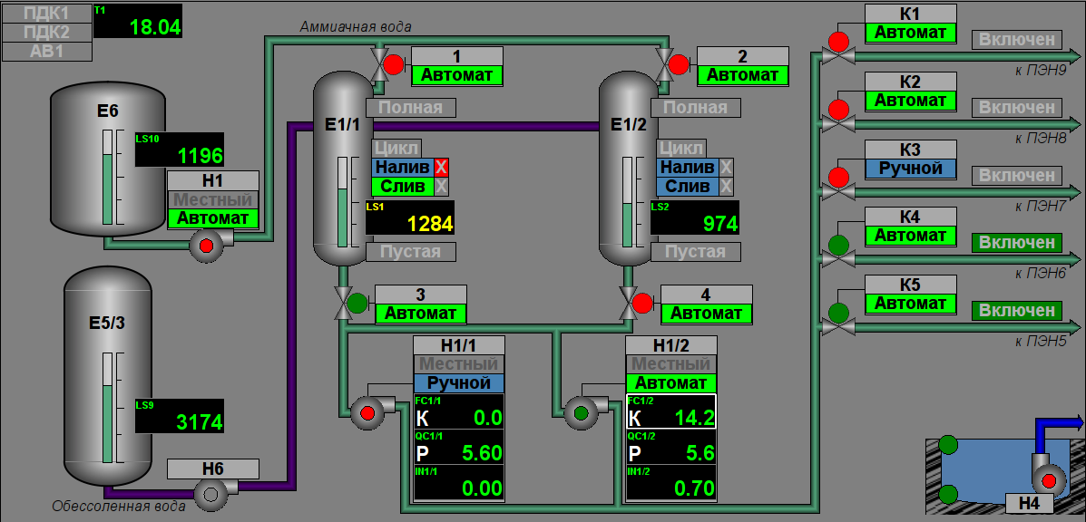

Amination

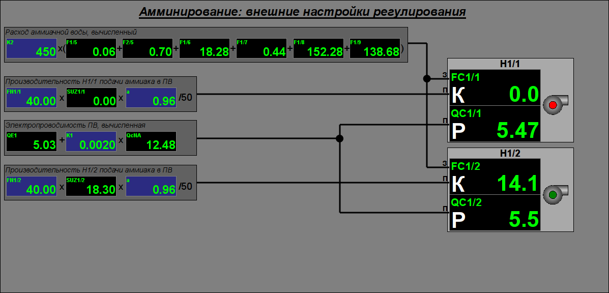

Controlling by the process of amination performs by two mnemonics, first one is "Main" (Fig.6) contained a mnemonic imagination of the technological process with elements of controlling, and second one is "Configuration of external regulation" (Fig. 7) contained configuration of external regulations, respectively.
Fig. 6. Amination: mnemonic "Main".
Fig. 7. Amination: mnemonic "Configuration of external regulation".

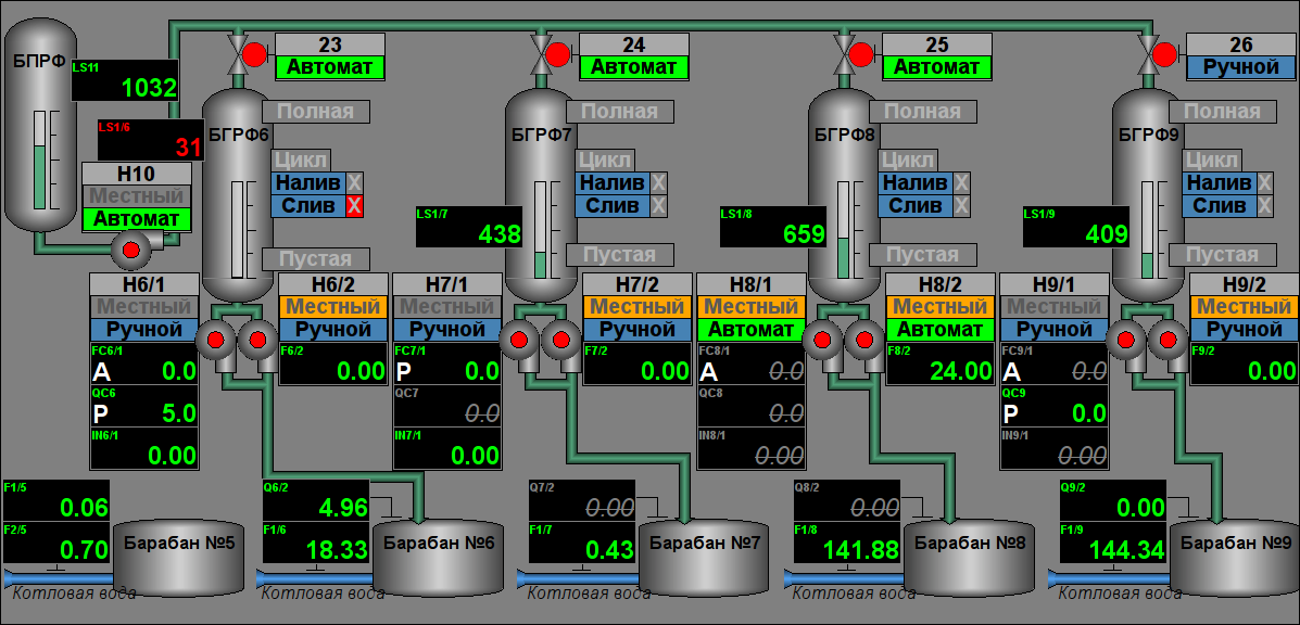

Hydrazine
Controlling by the process of hydrazine performs by three mnemonics, first two are "Main" (Fig. 8 and 9) contained a mnemonic imagination of the technological process with elements of controlling, and third one is "Configuration of external regulation" (Fig. 10) contained configuration of external regulations, respectively.
Fig. 8. Hydrazine: mnemonic "Main 1".
Fig. 9. Hydrazine: mnemonic "Main 2".
Fig. 10. Hydrazine: mnemonic "Configuration of external regulation".

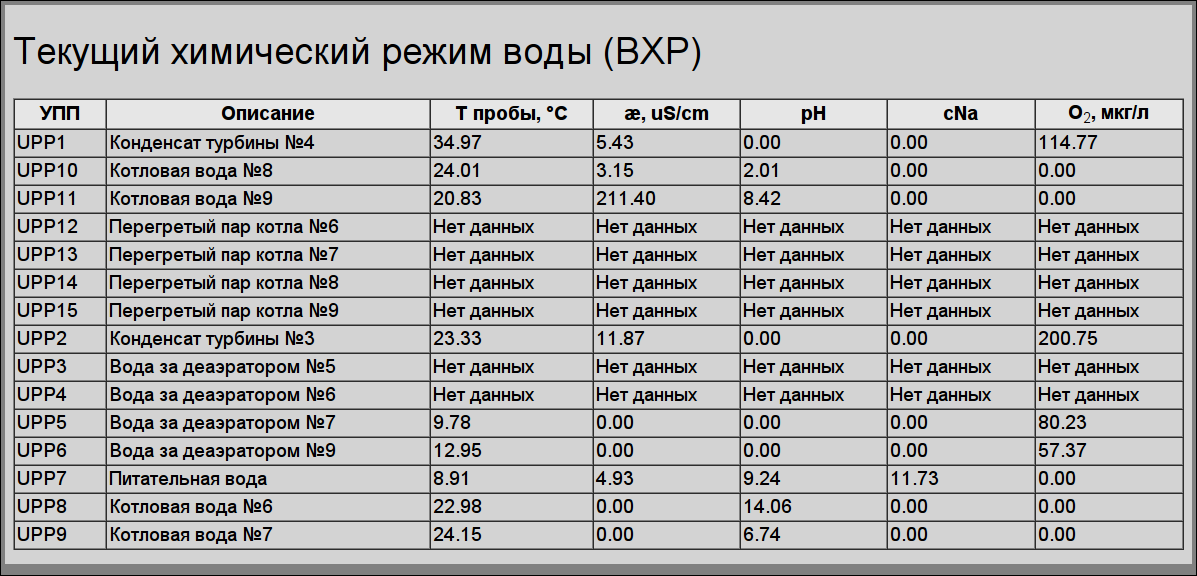

Chemical water mode (WChM)
Controlling by the chemical water mode performs by one mnemonic with a result table of water's parameters (Fig. 13).
Fig. 13. Chemical water mode: mnemonic "Main".

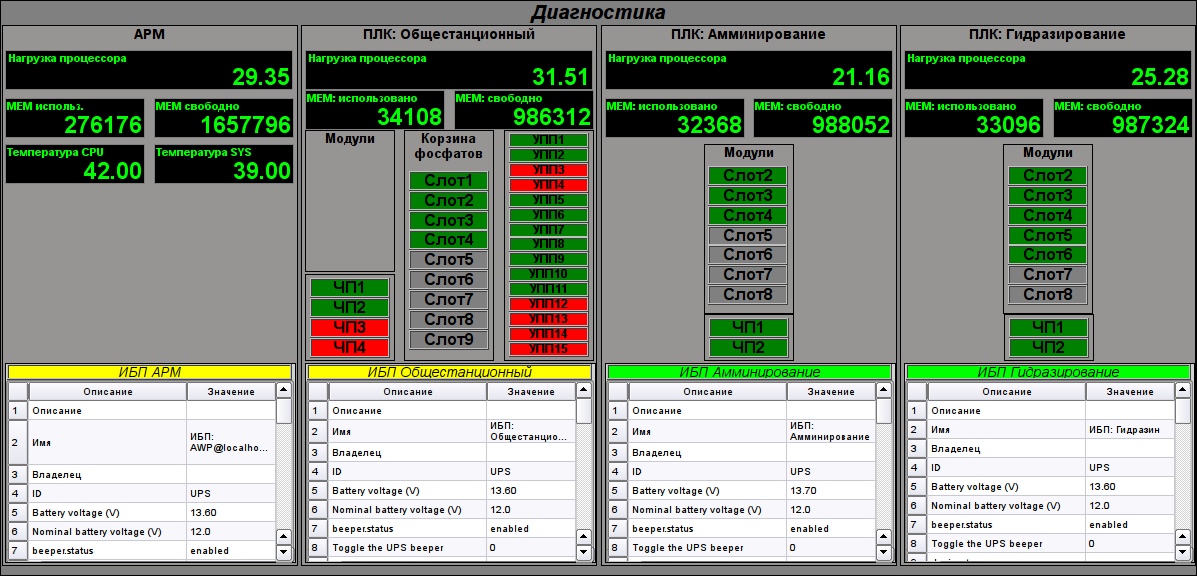

Diagnostic
Controlling by the equipment of the ACS performs by mnemonic "Main" (Fig. 14).
Fig. 14. Diagnostic: mnemonic "Main".

Controlling by process of the continuous blowing performs form AWP "Mills" by mnemonic "Main" (Fig.15).
Fig. 15. Continuous blowing: mnemonic "Main".

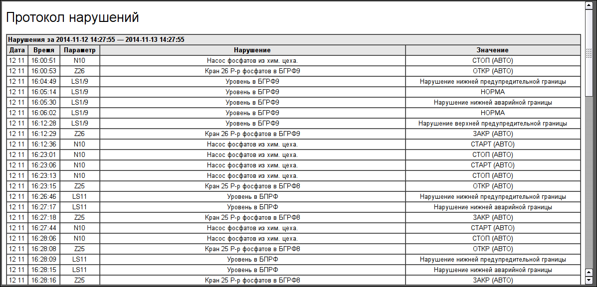

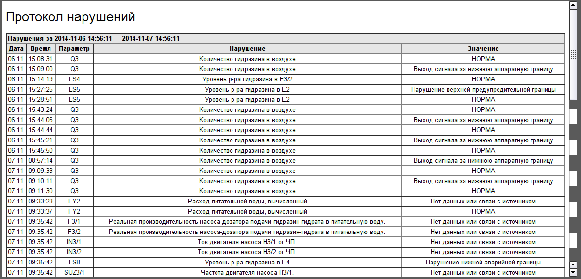

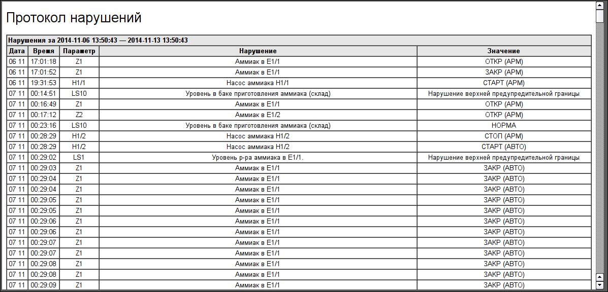

Protocol of violations
The protocol of violations (Fig. 18, 19, 20) provides for overview the violations in selected signal object (violation of order boards, inauthenticity, diagnostic of parameter and other).
