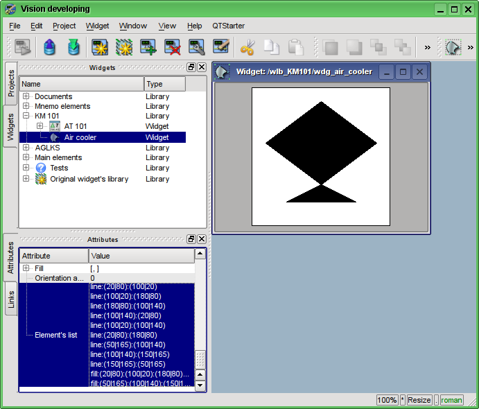

Now let's draw the visual presentation of the widget. This procedure can be done in two ways described below:
 (82 Kb)
Fig. 5.3.1.3. Entrance to the mode of drawing the widget, based on the primitive "Elementary figures."
In our example, we'll use the second method. To do this in the "Element's list" of the attributes inspector let's enter the list below and press "Ctrl" + "Enter".
line:(20|80):(100|20)
line:(100|20):(180|80)
line:(180|80):(100|140)
line:(100|140):(20|80)
line:(100|20):(100|140)
line:(20|80):(180|80)
line:(50|165):(100|140)
line:(100|140):(150|165)
line:(150|165):(50|165)
fill:(20|80):(100|20):(180|80):(100|140)
fill:(50|165):(100|140):(150|165)
All the points in our case are specified in the static form, since it is not provided the dynamics and change of coordinates in the mode of execution, and all the other parameters are left by default.
As a consequence, our widget will take the form shown in Fig. 5.3.1.4.
 (80 Kb)
Fig. 5.3.1.4. The image corresponding to the "Element's list" of the widget.

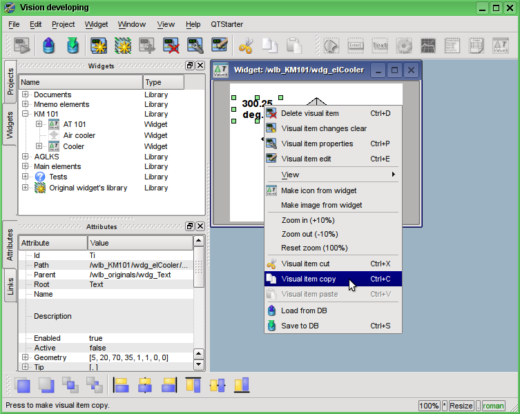

Now we'll copy the "Ti" widget in order to create an equivalent widget "To" (output temperature), as it is shown in Figure 5.3.2.10.
 (118 Kb)
Fig. 5.3.2.10. Copying of the "Ti" widget.

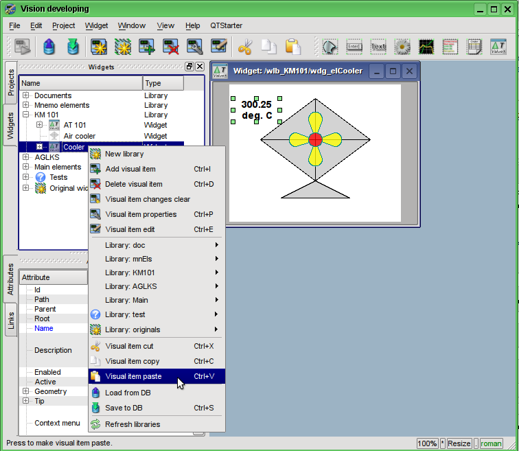

Let's paste the widget in the widget-container "Cooler" in the library "KM 101" (Fig. 5.3.2.11). In the dialog of the ID and the name entering for the newly created widget in the field "ID" we'll write "To", and the name field we'll leave blank.
 (112 Kb)
Fig. 5.3.2.11. Paste the copied widget to the widget-container "Cooler" of the library "KM 101".

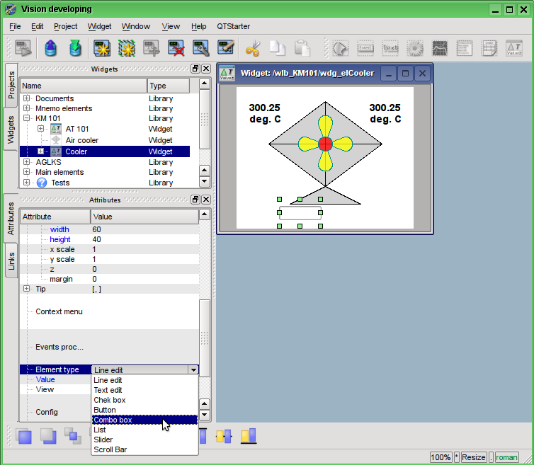

Now let's add the widget based on the primitive "Form's elements", which will be used as the ComboBox to select the productivity values of the cooler. The identifier will be "cw", and the "Name" field we'll leave blank. (Figure 5.3.2.13)
 (92 Kb)
Fig. 5.3.2.13. Adding the widget based on the primitive "Form's elements".
Let's set the parameters of the "Geometry" section of the "Attributes" tab for the newly added widget: coordinates "x", "y" of the upper left corner, width and height of 60, 158, 60 and 40, respectively. Let's change the "Elemetnt type" to the Combo Box, as it is shown in Fig. 5.3.2.14
 (92 Kb)
Fig. 5.3.2.14. Change the "Geometry" and "Element type" for the newly created widget.
